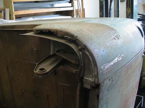

I replaced both cab corners in my F-4. I made all the patches. The piece you're looking for wasn't that hard to fab, i just drew out the center dimensions and hammered the edges down. Here's the best picture I have on my home computer. In in this picture I hadn't filled in the rest of rusted area yet:
Here's a picture after I welded in all of the patches:
