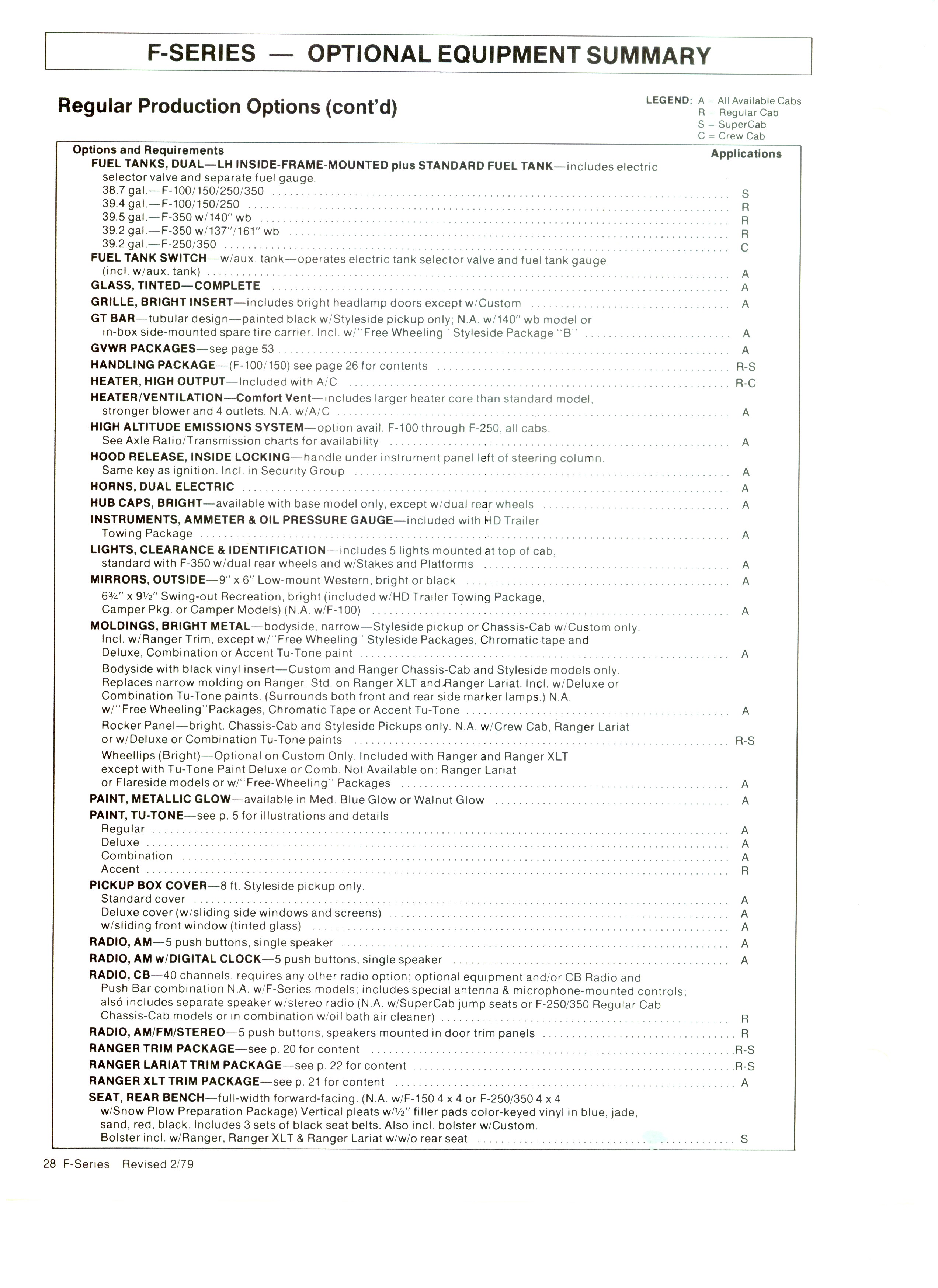

Fullsize image: http://www.supermotors.net/getfile/6...s-brochure.jpg

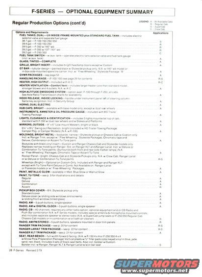

Here is another one I just scanned in. This brochure will show the paint option that this specific truck and states that it gets the racetrack trim upper and lower.
Fullsize image: http://www.supermotors.net/getfile/6...nt-options.jpg

There is no way on God's green earth I can read these brochures, even with the magnifiers I use for the microfiche slides.
The 1979 dealer facts book I have (do you have one?) makes no mention of Race Track mouldings on Customs or Rangers. This book is dated August 1978, so it's possible there was a second edition, tho I've never seen one.

The upper side mouldings were available on Customs as an option, but were painted black, they didn't come with vinyl inserts. They were also smaller in width. The wheel opening mouldings were also available. I made no mention of these mouldings types, just the Race Tracks.
Painted black? The upper molding in the dentside was painted black on a Custom? I have been around a long time and have never seen black painted molding. That has got to be pretty rare. I have seen the aluminum molding that was narrower than the aluminum molding with the inserts but also never in black. I presume by racetrack you are reffering to the lower trim for a tu-tone paint job?
Try clicking on the "fullsize image" link right below the inserted page and you won't need glasses or a magnifying glass.
What I have is the "79 Ford truck light facts" book put out by Ford in 2/79
Care to elaborate on this black molding some more? That 1st page of the brochure I posted specifically states under the "Moldings, bright metal that a Custom could be had with the "bodyside molding with vinyl insert". I am under the presumption that the bright metal molding would be the aluminum molding with the black vinyl insert.

As for Numberdummy's observance of the truck in question, he is absolutely right about the tailgate. It's been repainted, otherwise the Ford letters would be painted, or the trim piece that was mentioned would be present. And for it being all original, it obviously isn't.
He's wrong about the rectangular headlamps because they were standard on all trim levels in 1979. He's allowed a mistake now and then. I've made a hell of a lot of them in my time.
Could you order a Custom with every option avaliable? Short answer is yes, but it was seldom ever done. The dealer would talk most people out of it because a Ranger Lariat would be cheaper, when it was all added up, and you would get specific Lariat stuff not avaliable for the Custom.
