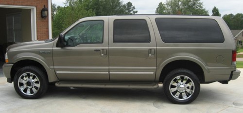

My truck has a twin.
Name:  new wheels_1.jpg
Diane

Right on... I like twins. Oh, you meant turbos
Attachment 11089
Diane
How much did it run you for the turbos?
Any MPG drop?
Where did you get em?

I think she Meant that her truck and H1449-6 look the same

Except she's got some phat wheels.
