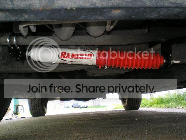

Does ranchos make them for a 2000 Ex 2wd?
Old Aug 26, 2008 | 06:55 PM
Monsta's Avatar
Monsta
Sit. Stay.
Joined: Oct 2001
Posts: 18,308
Likes: 20
From: Washington State
Yes, you need to look for stabilizer for a mid-70's F-150.
See this thread. You'll need brackets.
https://www.ford-trucks.com/forums/5...er-on-2wd.html

Will this work Rancho Suspension Single Stabilizer Kit : JC Whitney: Truck Accessories & Parts
And will the brackets they come with work?
