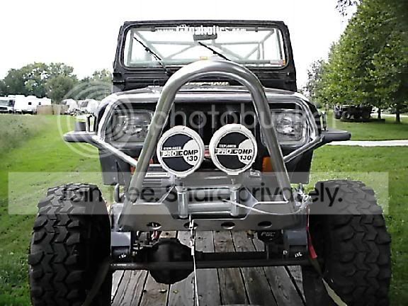

My truck is my daily driver. I will never take it offroad if I don't have to. If I do decide to go offroad it will be in my other ride which is also waiting for me when I get back. Here she is:
I'm just looking for an all terrain tire that is well mannered on the highway at fast speeds. I tend to be kind of heavy on the skinny pedal sometimes. any suggestions fo tires?

Your jeep is rocking!
Great job on the build!
