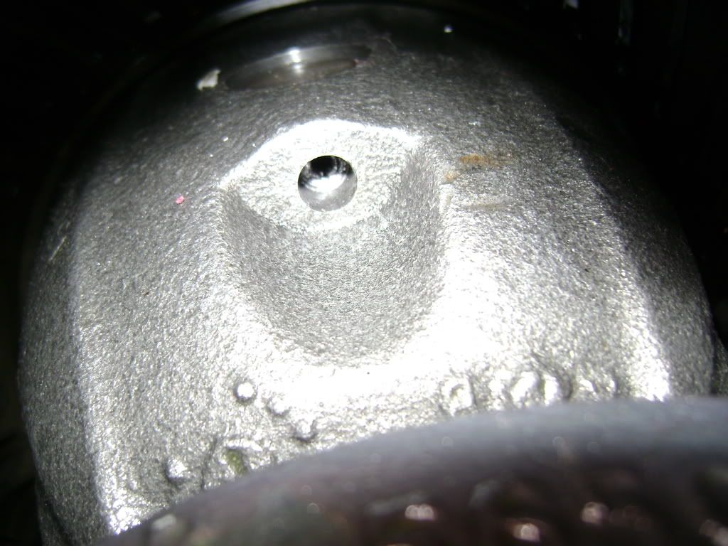

Heres what I am working with
Drivers side of the pin
Pass side
I am trying to avoid pulling the carrier, but if push comes to shove, I might just pull it
Anything im missing here?

I have always pulled those while on the bench. The 60 carrier is easy to remove, just make sure you keep the caps in order, and oriented in the right direction.
Re-torque them properly after the re-installation. Maks sure that you do not drop the races when you remove the carrier, and you should be just fine. You will not disturb any lash by doing this. I say this, as long as the bearing and shims are not removed. This is probably the easiest to do, and you will be victorious over that little roll pin.

oh, and which way does it come out?
Does it matter?

I do not believe it does, as the hole is not tapperd, but I have always tapped them out from the ring gear side.
From left to right as viewd from the back of inspection cover, but again, it does not matter.
For some odd reason, I always replace the little roll pin also, not out of necessity, it is just a practice of mine.

They do only come out one way. If you have been beating on it you can probably forget ever getting it back out. I know thats not what you wanted to hear.
thats fine, at least I know...
which way do they go?
in the picture above, is it from left to right?

got it out last night
it goes from left to right in the picture
