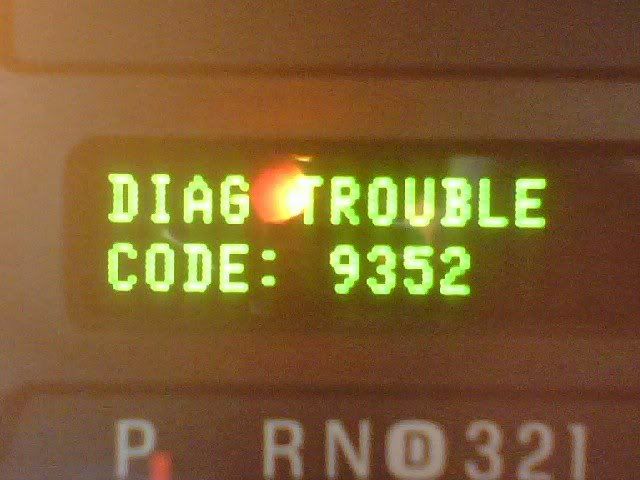

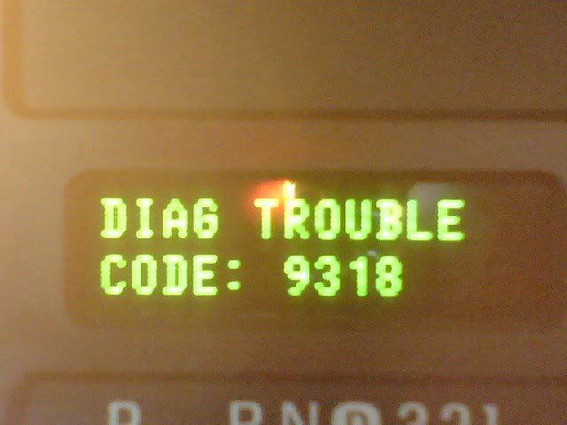

In respect to everything that is going with my truck, I thought I would do a diagnosis test using the truck's message display center by holding down the reset and set up buttons at the same time.
Upon toggeling through all the information given, I came to find 2 diagnostic trouble codes:
9318
9352
I stopped by the dealer and couldn't come up with an answer due to the fact that they have no letter in front of the number as they usually should to indicate if it is powertrain (p), chasis (c), body (b), and so on...
Anyone have any information on this or how to decipher what these codes mean?

after some searching I found out that code 9318 Battery voltage low (below 10v) and it seems there's no answer yet for the code 9352 even though a few members have it

Low battery voltage? Interesting. I just had both batteries and alternator replaced last week...
