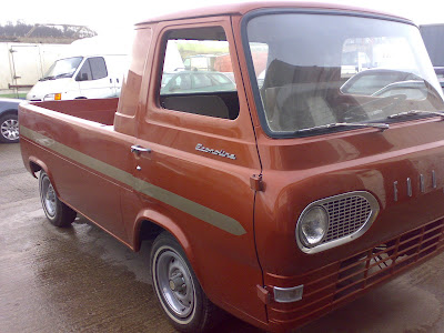

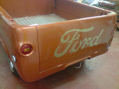

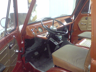

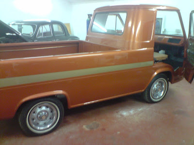

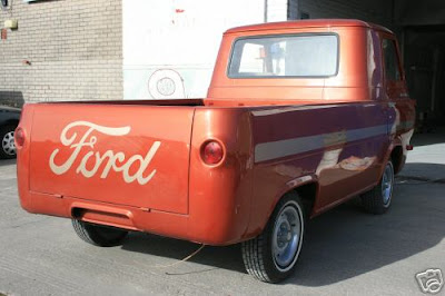

Right then, update time, She's not far off being completed, just a few issues left.
I am finding out that my mechanic is a top guy when it comes to classics,he has repaired and re-sprayed my steering wheel which is looking fantastic, he just recommends not to use it when climbing in and out so that will be good for now, he has fitted a window wash bottle and jets (legal requirement in UK) all chrome work in back on,floor mat in, he has re-wired it from scratch and has found and fitted tail lights that with integral amber turn lights (not essential for UK MOT because of the age of the vehicle but I wanted them on for safety whilst keeping the single lights as it keeps the tail looking clean) he has fitted turn signal switch from an old Land Rover that just clamps around the steering column and only cost about £20 and any bushes, bearings etc I haven't been able to find at Mac's or C&G he has found equivalents over here or machined new ones so the bodywork and chassis is just about done and looking great. He also gave the wheels a paint up and polish and they look lovely, so I can put the new wheels on hold for now.
Next thing was the engine, he fired it up and it wasn't looking good and was looking at engine strip and rebuild which wasn't good as I am getting close to my limit on funds and his labour charges ain't cheap! He investigated and found a bent push rod so that is getting ordered and the oil pressure sender is shot so a new one of those, the carb has been rebuilt badly so I am looking for a new one or alternative as they are only offering a rebuild service now at Mac's and my mechanic reckons rebuilds are only 50% succesfull anyway. He says that the enginge is actually in quite good condition giving 150 psi compression (which he said was good, I wouldn't have a clue!)
He drove it to the MOT station and back to get tested which it has passed!
(MOT is the yearly safety and compliance check in the UK, MOT standing for Ministry Of Transport) but there is a knocking when you release the clutch after changing gear, without an expensive strip- down of the clutch and gearbox, my man reckons it is the clutch pilot bushing that is gone not the gearbox as the vibration is different each time you release the clutch, sometimes hardly vibrating at all so I am going to hope it is that! The gearbox back mounting bushing had been repaired with some liquid rubber stuff, and was out of line and the metal rod was showing through so he found one off a Vauxhall Vectra that fitted (UK General Motors car) the speedo cable and nylon gear needs replacing and the only other issue is there is some play in the back end side to side, he reckons it isn't the bearings as the wheels are fine, more likely some shims/gaskets are missing (the guy I bought it off was definitley a bodywork specialist, not a mechanic, there weren't any engine mount bolts fitted!) but that's about it!! I am now in the process of getting UK registration plates, as she has passed the MOT, so she should be on the road in 2 weeks time (fingers crossed) giving me the time to get these last issues sorted.
If anyone has any ideas on the clutch vibration or the side to side movement on the back axle that would be great, and also where to get a 144 1bbl carb for a '61 and also speedo gear and cable as there is nothing listed on mac's for econo's. Also, I bought one of those locking gas caps, but it doesn't seem to fit right, it sits too far off the bodywork for my liking, does anyone know of issues with these?
Thanks again guy's
Frank
P.S. A word of advice to anyone restoring an econo, BUY THE PARTS BOOK/CD mentioned earlier in this thread, I just wish I had done so when I started on this (and so does my mechanic!) It is fantastic, it has exploded drawings of just about everything, and you can decode your vin plate with it.
Here are some latest pics:

Good to hear. I see the truck has a endgate that someone has made for it. It looks really sharp. As for finding an original in good shape are like pulling Hens teeth. Meaning next to none are aorund to find. If a person finds a good endgate it is worth its weight in gold.
