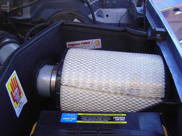

K&N is frowned on very much around here. You need to get a 6637 from NAPA and either a 4" piece of exhaust pipe bent at 45* or a 3" 45* PVC fitting. You can also get a 45* 4" pipe directly from NAPA also (not sure on part #).

I still have the standard filter, and the K&N was just a filter element in the stock air-box, not a true CAI kit.
So what is the exhaust & pvc pipe for??

The K&N drop in elements have been known to allow too much dust in and ruin the turbo blades. The pipes are to connect the 6637 air filter to the existing intake hose. Do a search here for 6637 and it should describe it very well. I would post up a pic but I can't access my pics at this computer

Look here:
https://www.ford-trucks.com/forums/7...37-filter.html
Here for pic, You don't need the box but it may give you an idea
http://www.supermotors.net/getfile/5...1607-051-2.jpg
Here is a pipe from NAPA:
NAPAONLINE®
More pics:
https://www.ford-trucks.com/forums/7...first-mod.html
Here are the pics I was looking for. It should make it clear for ya.
https://www.ford-trucks.com/forums/7...my-6637-a.html
