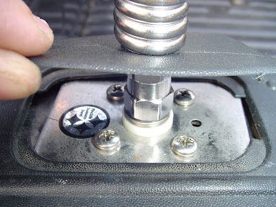

Check out how I mounted my 5 foot firestik antenna. I used a Firestik Stake hole mount, and covered it up with the plastic stake hold cover that comes stock on superduties. I just drilled a little hole in the plastic cover and slipped it over my antenna. The firestik stake hole mount is really well made stainless steel and mounts flush enough that you can still cover it up with the little plastic cover.

<a href="http://picasaweb.google.com/boodaddy/F250CBAnd10mRadioPictures/photo#5154722718888920498"><img src="http://lh4.ggpht.com/boodaddy/R4lBAH8ChbI/AAAAAAAAAR4/pLw9CgVsX70/s400/DSC01897.JPG" /></a>
and HEres what the mount looks like under the cover:
<a href="http://picasaweb.google.com/boodaddy/F250CBAnd10mRadioPictures/photo#5154724217832506898"><img src="http://lh5.ggpht.com/boodaddy/R4lCXX8ChhI/AAAAAAAAASs/octdLzMukCE/s400/DSC01907.JPG" /></a>
I get a very low SWR (about a 1.3) due to the firestik being top loaded, and it seems to propogate really well. Im very happy with this mount

That is a very clean install! Respect and rep points your way!

Thanks! Heres some more info on the mount i used:
STAKE HOLE POCKET MOUNT
And here is the antenna I have:
Firestik II "FS Series" CB Antennas
I have the 5 foot version. I like Firestik cause they are top loaded, which puts your load above the roof line and helps with keeping SWR down, and maximizing signal output.
