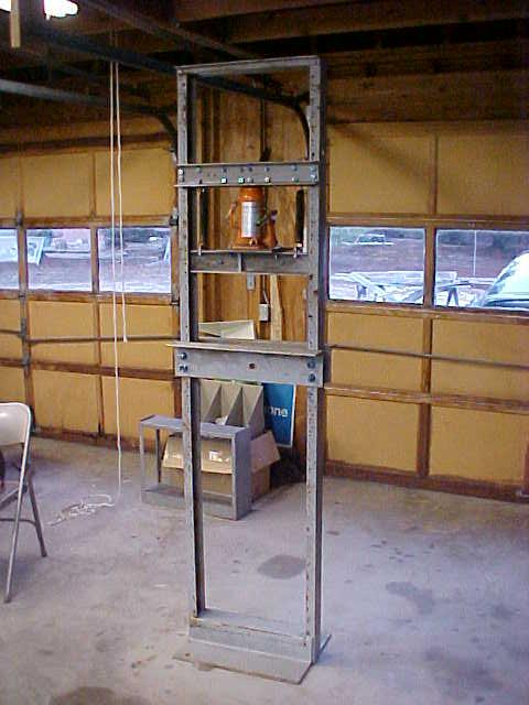

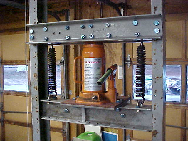

Originally Posted by Monster-4
1975StroppeBaja - What size (tons) press you have?
I built the press myself about 5 years ago out of an old steel equipment frame, some stout springs and a 12-ton bottle jack.
Thanks for the all the compliments and points guys! I'm glad to see it might help out some folks!
Here's a few pics of the press...
