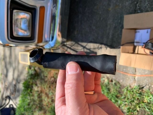

so there is a hose and elbow as you describe, but no check ball or anything in the elbow. See images
I’m new to this motor/truck, so flame suit is on ...

That looks like the breather for the PCV system. When the valve opens up and applies vacuum to the crank case, that breather allows clean air to enter from the opposite side.
On my 87 5.0, there is a hole (with a grommet) in the back of the intake manifold that the PCV valve is stuck into. Then there is a hose on the oil filler neck that gets clean air from the throttle body.
In both cases, the hose coming from the valve goes to a manifold vacuum source.
What's on the other valve cover?

looks like the PCV is on top of the oil filler cap then. I will check that out and update ...
