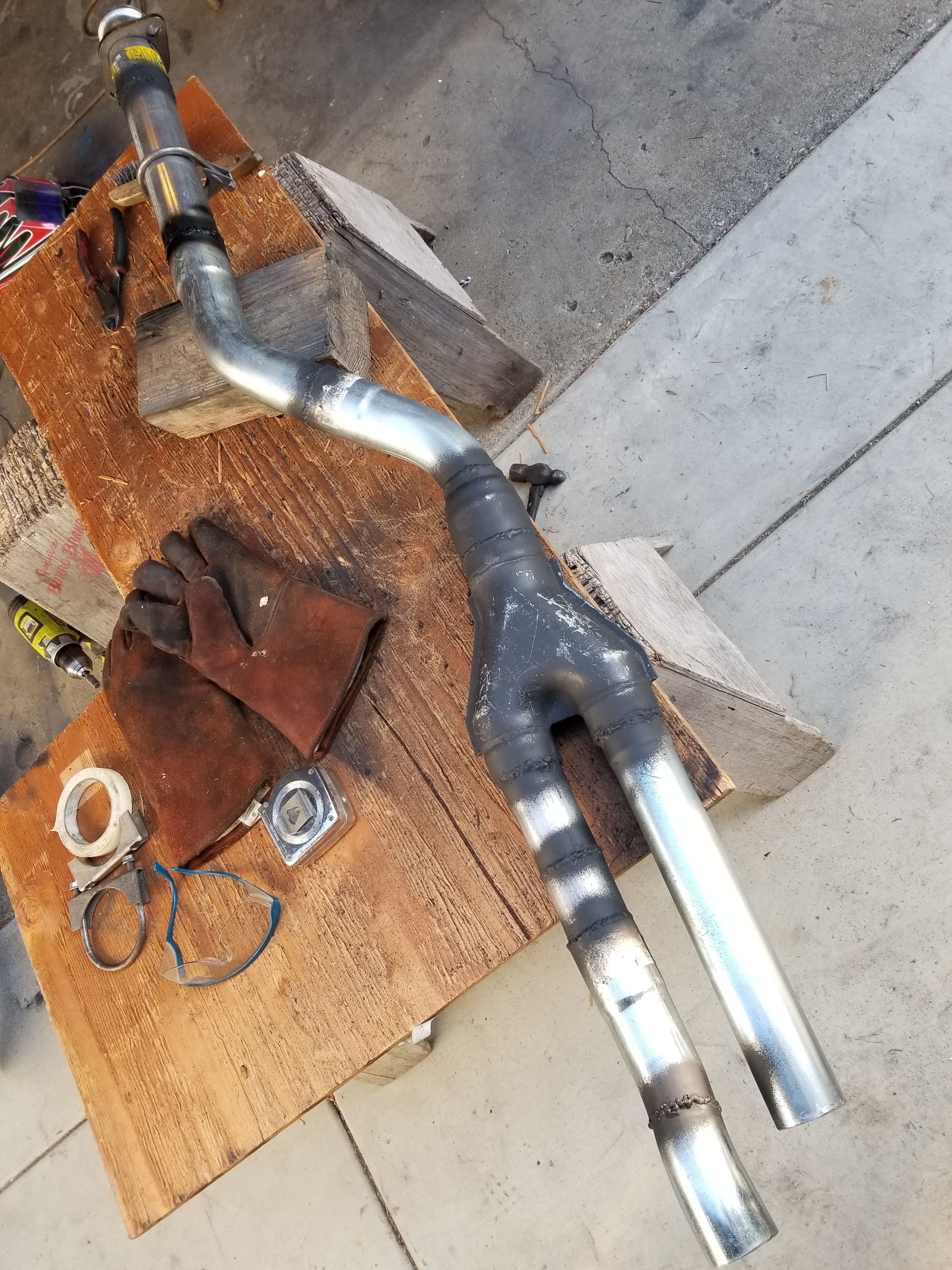

Old Jun 30, 2022 | 02:29 PM
F-250 restorer's Avatar
F-250 restorer
Joined: Mar 2008
Posts: 7,196
Likes: 387
From: Near Los Angeles
I welded my own as well. I bought most of my tube, Y pipe, hangers from Summit, as well as all the bends that I could. I also bought some mandrel bends from the local parts house. My welds look sucky as well, but hey, they hold. I guess for the entire system I spent over $300, and half of that was for the Flowmaster muffler.
Attachment 278122
Attachment 278123

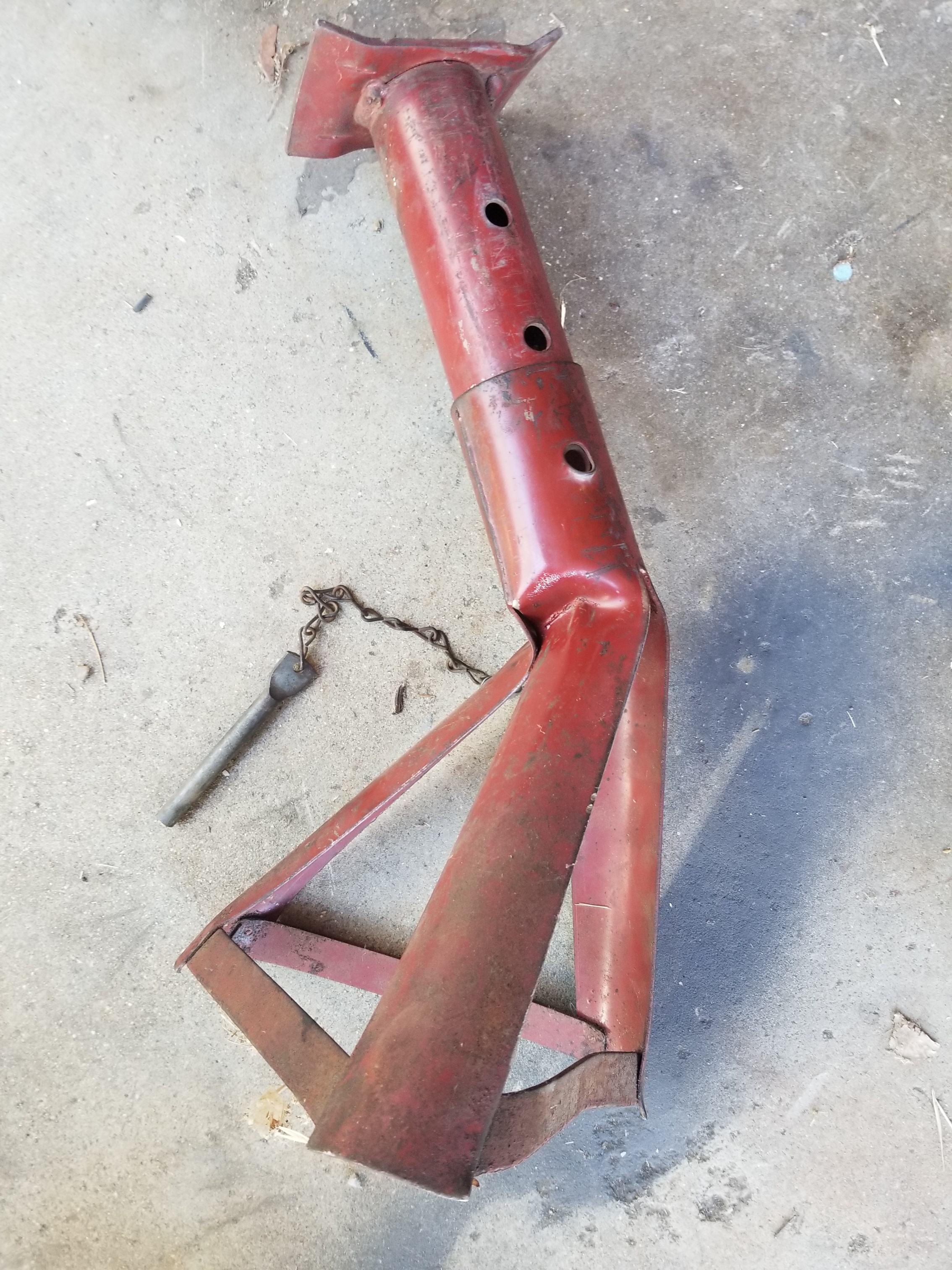

Oh, a quick word of wisdom: Use quality jacks and or quality jack stands.
Attachment 278124
