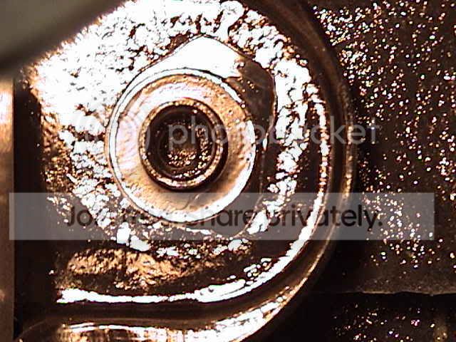

Any cab from 73-79 trucks will swap over. The highboys have wider frame mounting perches in the rear. Front lines up, rear-you'll need to drill out the the knockouts provided in the rear of the cab. Below is a view from underneath. You can see the "knockout" template you will need to drill out.
