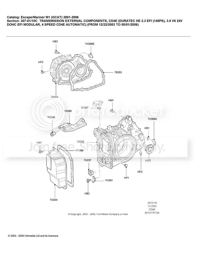

XC3Z-7B155-BA is replaced by XC3Z-7B155-D
but there is a filter in the escape,well more of a screen 7A098
