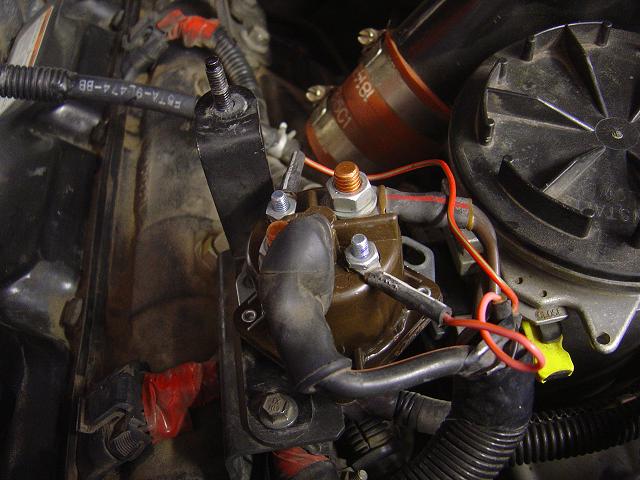

Here's how mine is installed:
http://www.supermotors.net/getfile/5...3107-003-2.jpg
