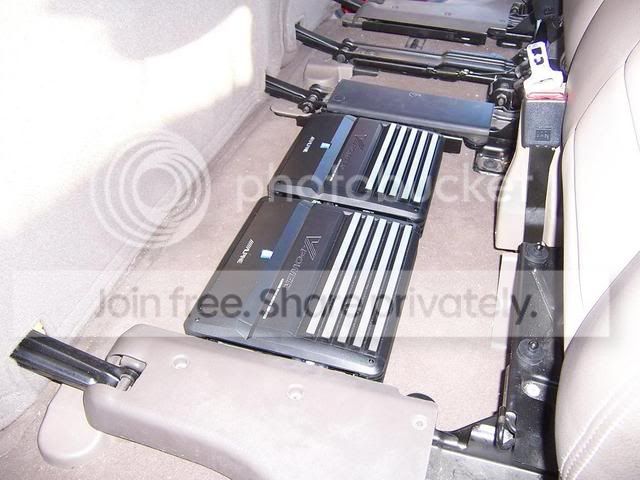

i don't know exactly which amps you're talking about, but i fit 2 under the second row seats..
there might even be enough room to stack a third..
i made a pathetic try at getting that panel off in the rear..too lazy to pull the seat belt mount...all i was doing was running cable anyway..it started prying off easily though..just a PITA to finish the deal and remove it..

I wish I had a 2nd row bench, for the seating capacity and the hiding spot. I have captains chairs, they have very little room between their brackets.
This is the alpine amp I am looking at, it is a class D (digital) and it is very small for its output.
