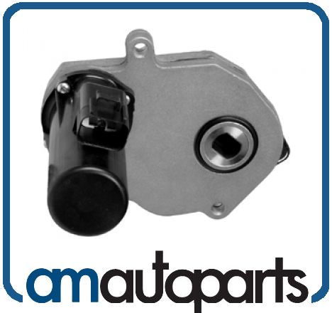

Well, just back back from the dealership... its the shift motor for the transfer case thats gone. Sounds not to bad right?..... $850 for the motor!! I'm going to see about getting a used one or see if one of the Ford parts sponsors on here can do better. According to the tranny tech, it's not uncommon for these to go. Just thought this might help out someone else whose four whell drive sustem stops functioning.

Really good question. From what I remember on my 2000 there are 2 bolts holding on the electric motor and a wire plug in. I found a replacement part around $189 and 30 minutes to install after the truck is on the hoist. ON mine I would not even jack it,, just slide under and change it.
$850 sounds a bit like taking advantage of someone driving in the snow. Summer prices would probably be lower is my guess.

Yeah, I contacted one of the parts sponsors on here and they have it for $250 plus shipping.
Vettedvr, where is the motor located and is it easily accessible? Thanx...

It is just behind the transmission at the front of the driveshaft. If you crawl under you should see it on the transfer case. I think it is on the front if I remember correctly.
You might just clean the connections before you order a new one.
