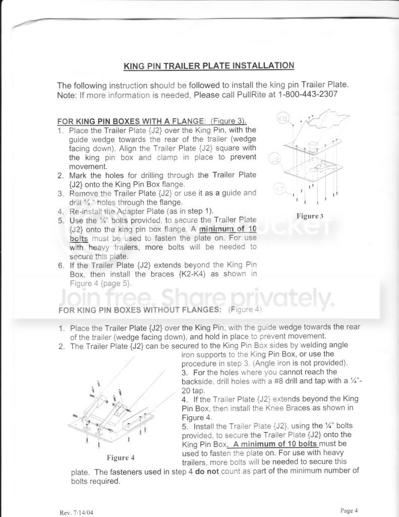

Originally Posted by johnny567
Ive got the superglide & love it. dont worry about using other vehicles as the adapter plate comes off in about 10 minutes, just about 10 bolts hold it on. the only real disadvantages are price of course (got mine on e-bay good deal) & the fact that you have to back into it pretty straight on. if you do get one just keep the rails greased well with white lithium grease & youll be good to go.
Proper installation of that adapter plate has 4-1"welds to assist in holding it on. The bolts would probably hold it OK, but if something should happen and it was not properly installed insurance may not cover it.

Originally Posted by SAVOY05
You may want to stay away from the B&W. It is not a slider. I believe you posted you truck was a short bed. The camper may hit the cab of the truck.
I think this all depends on how the hitch is installed and how you setup the companion. I have this setup and personally really like it. But even with a long bed, if you get stupid, you sure enough could make contact between the cab and trailer. I think it boils down to paying attention to what you are doing, doesn't matter what type of hitch or trailer.
Old Mar 4, 2008 | 01:56 PM
johnny567's Avatar
johnny567
Joined: Jan 2006
Posts: 286
The capture plate does not require welding unless the plate is larger than the pinbox it`s getting attached to, even then you only need to weld some angle to the sides if needed or the front knee braces if needed or some flanges on the back if needed & then bolt it to the added material. mine didnt require any welding as the capture plate fit correctly.
