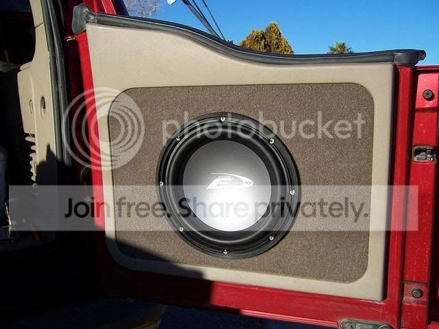

i kept the stock HU..i put a pair of Infinity 5x7's in the front doors..
i put a pair of Alpine amps under the second row seats..
i cut in a pair of Alpine 10's into the barn doors..
the hardest part was the subs in the barn doors...i put a layer of 1/2" plywood between the trim panels and inside of doors for support..it gave a nice soild place to mount the speakers to..then a matter of cutting the holes...first in the plywood and then the panel...the inside of the doors have some really goofy molding in the fiberglass and you have to get pretty creative in the plywood cutting to get it to fit right..
the depth of the barn doors varies because of the shape of them...i found a nice spot where i could get 5 3/4" of depth from the front of the trim panels..shallow mount subs would be your best bet, just to be safe...12" subs would also fit in the barn doors..
then run a whole bunch of wire..i took the sub feeds through the rear trim panels, then drilled into the tailight housings and out to the doors...the small piece of wire between the doors and rear quarter panels is all you can see in the whole truck..
now i'm trying to get rid of the rattles...the clips that hold the barn door trim panels don't like to be used twice...there must be 10 in each panel...new ones are $3.84 from the dealer here..

Oh...I was posting while others were. Great sub install pics!
thanks monsta..just trying to share a little and get my post count up so i can have a sig too..
