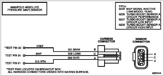

Is there any way to tap into the map sensor with a volt meter or something and use it as a boost gauge?

I suppose it's possible but you will need something to convert the digital signal into something useful (psi). If there are elctrical PSI gages, I would bet they are analog the MAP is digital, it's a variable capacitance sensor supplied with a 5-volt reference signal from the (PCM) and produces a digital frequency signal.

this is how banks provides the boost signal to the 6 gun tuner, it shows 1 psi lower than the auto enginuity live data feed though

Well you convet to psi yourself. Like for every Hz or whateverer = 3 psi. you see what I mean? I talking poor man stuff a way to test without buying expensive gauges and having to setting them up.

Scat, if you can get a guage to read volts, I will pull up my Auto Enginuity and tell you what voltage applies to what boost pressure, the live scan give that info.

Got the volt meter. It would be great if you could get me that info. Thanks
