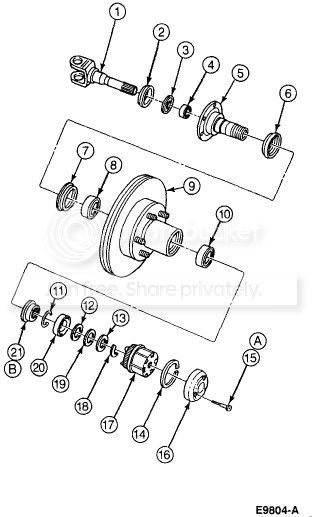

Ok 95 4x4,auto hubs with 3 screw cap. Want to change to manual. Bought the warn hubs AND the kit as sugested for the 3 screw cap(lock washers & nuts).
Problem is when I took out the auto stuff I noticed that there were NONE of the 3 thrust washers OR the C ring that goes in the slot about a inch and half from the outter end of the shaft. The auto hubs were inop when I bought the truck. Now are those needed and if so where can I get them. Parts missing are #12,13,18,19
Any help please?

. . . . . You are going to need to READ the instruction's REALLY carefully>>>>>>> it is stated,,,,," IF you are changing over to WARN Manual's from the =3-screw_cap Auto-Hub's, YOU WILL NEED TO have the Spindle Nut Conversion Kit " as well, FIRST ! ! ! ........and then you can follow that link for what " fmr9 " has given for ya on the earlier post .......{ i even have some Techi-Help on this with/pic's in my Gallery_album in my sig....}
