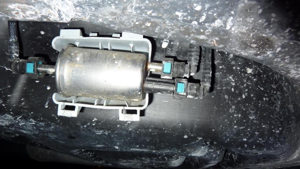

Pinch type inserts???
I have fuel filter set up just like this.
It was so easy that I screwed up and wrecked one of the blue inserts.
Anyone know if the blue pieces can be bought and replaced?
Appreciate it if so .
THANKS

Anyone have any knowledge of where I might be able to get another blue clip or insert like shown above??
I have been searching online catalogs and there are so many varieties I been struggling.
Hate the thought of leaving the one I tore up in there.
It is not leaking since I replaced the filter, but I know how my luck is...
Hate to not be safe !!!
THANKS
