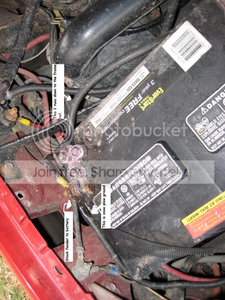

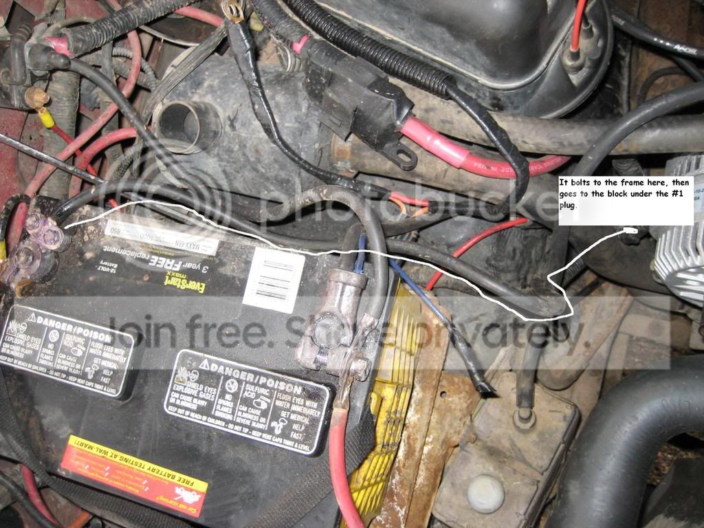

Mine doesnt go to the fender. There is the stock little wire that goes from the fender to the terminal. I took some better pics of how its run, and of how the braided wire is on it.
This pic is the terminal and where the grounds are.
This pic is the ground wire running down to the frame rail.

Awesome,
Thanks so much for taking all the time to show me those detailed pictures...its helps alot. My truck is a 250 so i guess the wire is slightly different, but im going to buy the new cables in a few hours. We are under a "blizzard Warning" (50+ mph wind w/ 11" of snow and windchills down to -30) so i might not get to it today as i cant fit her in my garage.
