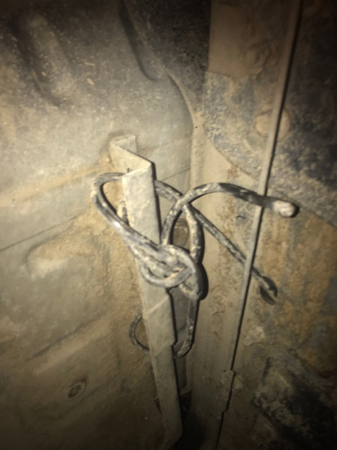

The cord is hanging down on drivers side fuel pump
Originally Posted by shelbnreno2020
I did look in fender and wheel space but can not see the exact spot to see is the block heater cord ran to drivers side
that is a picture of the drivers side fuel pump the cord seems to be to thick to be 12v

There's nothing on the drivers side related to this.
The block heater is above the starter, hard to see unless you remove the starter or the passenger side fender liner. The cord runs up the passenger side to the front bumper, where the plug end is typically hidden behind the bumper until its first pulled out.

Thank you I just found it and your right I have the two prongs
thank you I just found it I see the two prongs I have been having a no start due to how cold it is in single digits but when it was higher in temp it started up some times took a bit of cranking. Thank you for your help
