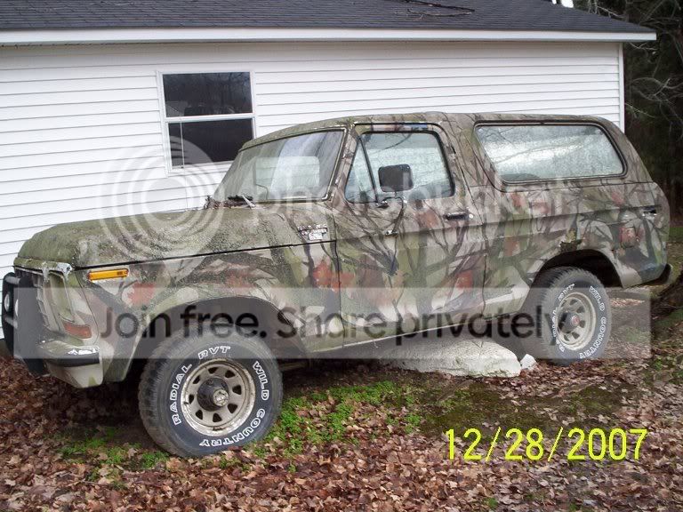

Well I finally got what I had been wanting. 79 Bronco. It has a new rebuilt 351M, good driveline, seats, and carpet. But it is mildewed and will need to be cleaned good. Now for the bad, the door jams are rusted bad from people not closing the door compltely and water running down it. From the front of the front seats forward the floor will have to be replaced. The wheel arches and are few other places are rusted, but I think now I can clean out the rust best as possible and fill it with Kitty Hair(fiberglass like bondo) to last a few years until I have the money to do it right. The back glass window is messing. I guess its alright though, I only gave $450 for her. Yall think she was worth it?

Talking That thing could be a Canada Bronco with all the MapleLeafs on it LOL.
How can you go wrong if you only paid $450 for it.
You can buy patch panels for all the rusted spots and the musty smell can be fixed too, take the Carpet out and shampoo it and let it dry outside if it's good or just throw it away and get complete new carpet from Jeffs bronco graveyard for $205 and start over or if it's just going to be a bush truck take the carpet out clean and dry the floors and then get it sprayed with Line-X or one of the other bedliners.
Either way you got a great truck and you are sure to have a lot of fun with it,
Just so you know the back window will only fit from a 78 or 79 unless you update the cap too the tailgates are all the same just the glass and cap change so just match the cap year to the glass year if you can't find a 78/79 glass.
