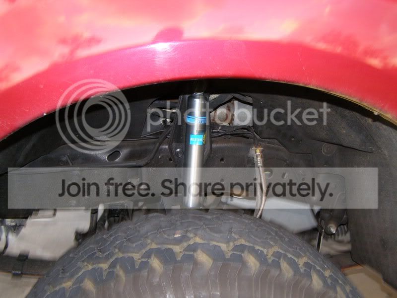

alrite another question where are the hoses that connect to the hubs

They are black hoses, about 3/8" OD. They press onto a barbed fitting just about the frame rail and then run down to the wheels and into the hubs in the back.
I changed my rubber hoses and went to the braided hoses from DieselSite when I was going through this problem. If you look in this pic you can see the vacuum hose coming from above the frame rail and heading down.

thanks alot that picture really helped hopefully this is my problem
