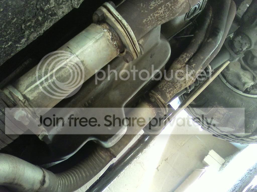

If you try to tighten them 1st a little to get them moving that usually works, I got mine off and they were so bad, there was no head on 1/2 the bolts and i used some easy out sockets to grip what ever was left. What brand did you get? My flowtechs hit my trans pan, i need to get a torch so i can heat the tubes and moved it away from the pan. How do you plan on doing your y pipe/ or true dual y?

Ill take some pics of my truck how I have the Y pipe and the headers, maybe it will give you some ideas, My header bolts dont come loose I just used lock washers on ARP bolts.

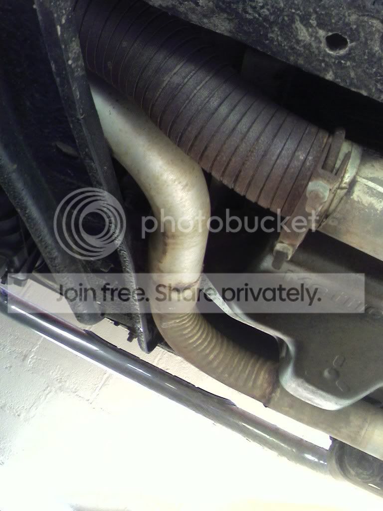

Thanks for all the ideas guys I Hope it goes well with Pb blaster and heat but i know that it wont be that easy it never is its just my luck. Any pics people have from building there own y pipes would be greatly appreciated thanks again. Matt

Here are some pics of how I made my Y pipe and such.
