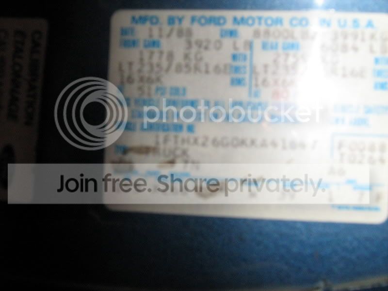

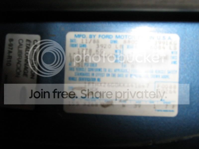

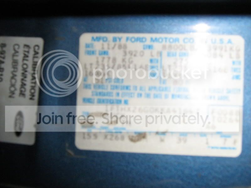

i had a feeling someone was going to say that, it's too cold for me to write the numbers down, plus i don't know which ones i'm looking for... here's some pics, not the best quality unfortunatly

What appears to be 39 is the rear axle code:
Sterling 10.25 / 3.55-1 / Non Limited Slip / 6200 lb. Rear Axle Capacity.
The axle code usually is three digits for a 4WD, with the third being the code for the front axle, but all I see is 39.
I can't make out the trans code in the blurry pic. Looks like an M..??...but I'm not sure.
M = Toyo Kogyo (Mazda) 5 speed overdrive.

155 x268 (body which i didn't copy) W 39
that's all there is along the bottom row, didn't read which any of them are, the W is the trans, the 39 is the axle, can't remember the first 2... a snow storm blew in over the past half hour

The tranny is the ZF 5 speed. Good tranny, but I've never seen it identified as a W. It should be a Z. Maybe someone who once worked for Ford could explain that one.
The front axle is a Dana 50 TTB.
The transfer case is a BW 1356.
