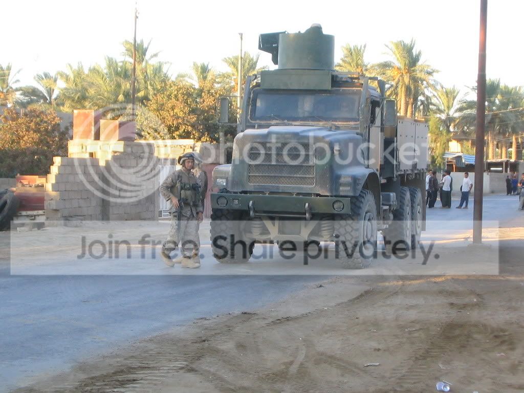

Originally Posted by JoeTrotter
///SNIP///
Izzy, have you driven the MTVR (7-ton) with the C-12? Sweet machine!
No, but just recently one of my co-workers out here in a classified sandy location got a Stewart-Stevenson with Cat 3126 stuck, then got the below (Hemet) stuck trying to get it out.
Old Nov 15, 2007 | 04:05 PM
JoeTrotter's Avatar
JoeTrotter
Joined: Jul 2006
Posts: 226
From: Brighton, CO
Those look sweet, a man could accomplish a lot with one in his fleet! If Bill Gates were to find me and say "I'll give you either a Ferrari or a 7-Ton," I'd say "7-Ton!"
