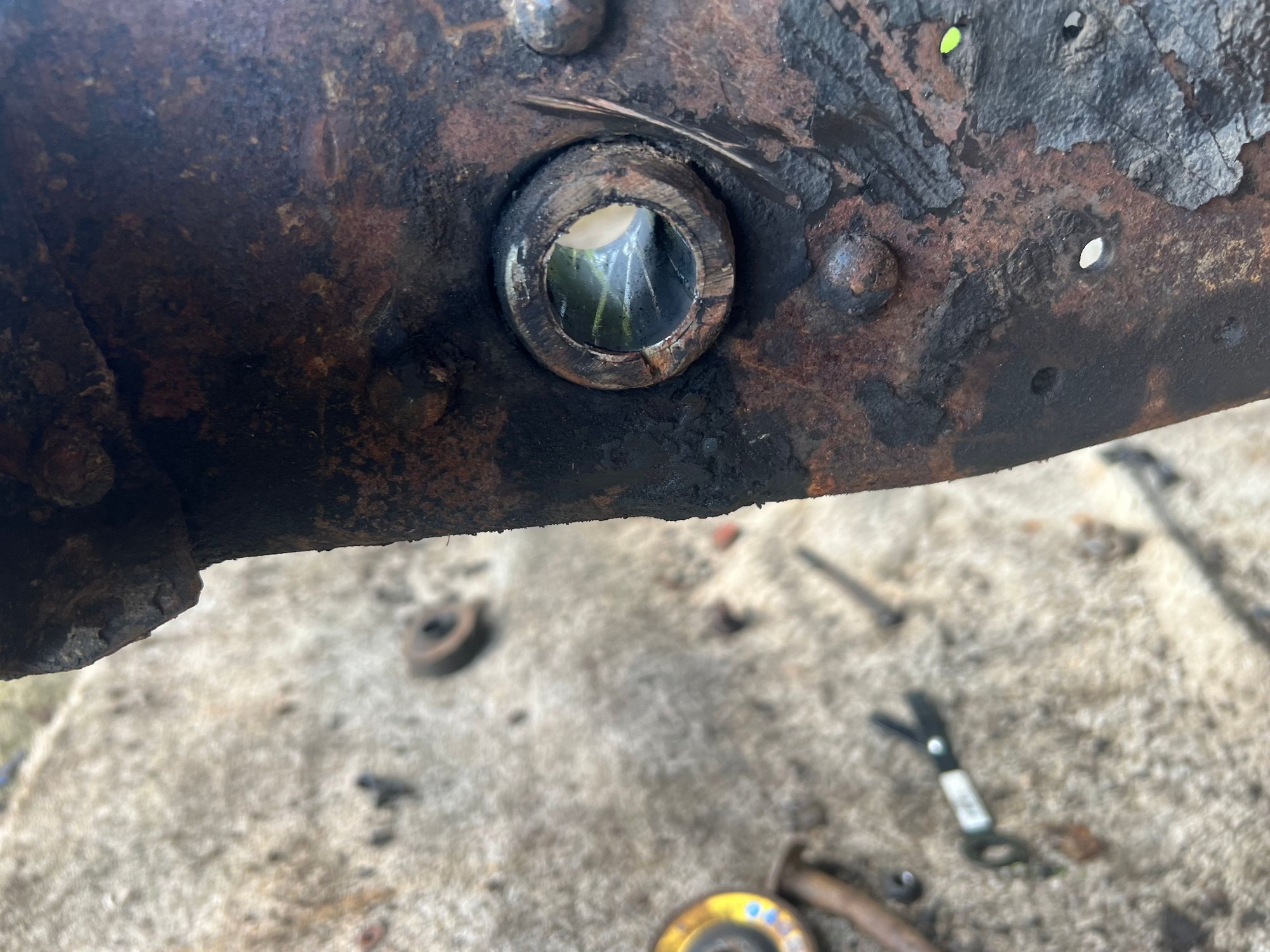

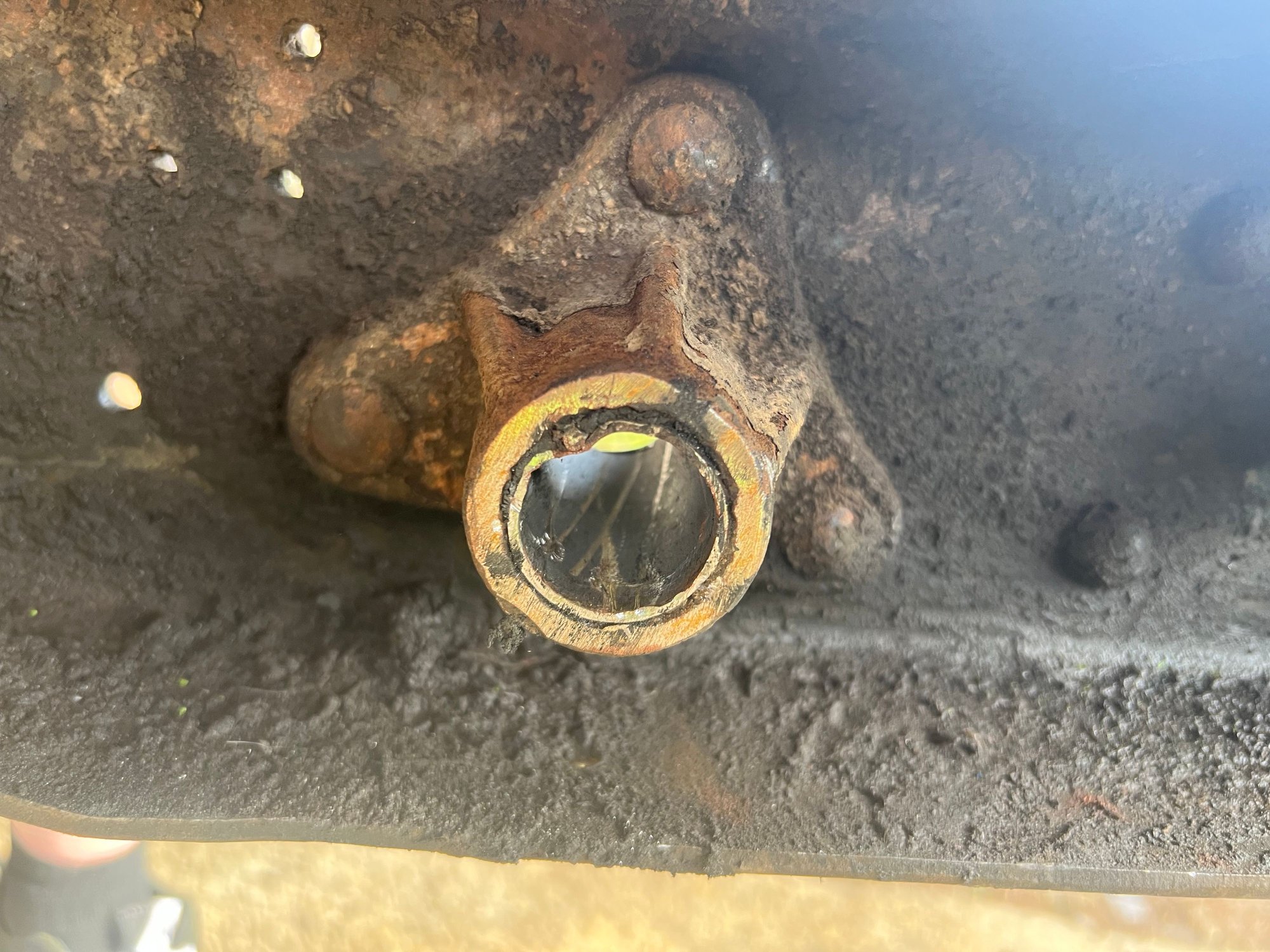

Old May 9, 2023 | 07:34 PM
BD2064's Avatar
BD2064
4wd Low
Joined: May 2022
Posts: 11
Are these what you’re talking about because I’m looking for these as well?

Bushings
You're responding to a post from 11/14/2007.
Yeah I didn’t see that but I’ve been looking for what these are called to replace them and I can’t find them do you know what those bushings are called?
Old May 9, 2023 | 09:20 PM
ivsamhain's Avatar
ivsamhain
Joined: Nov 2018
Posts: 563
Likes: 143
From: CA
Upper shackle bushing or something along those lines. Rock auto has them. Leave the rivets, you just need to remove the sleeve from the casting. I didn’t have any trouble but I did utilize the torch, mind where you aim it.
