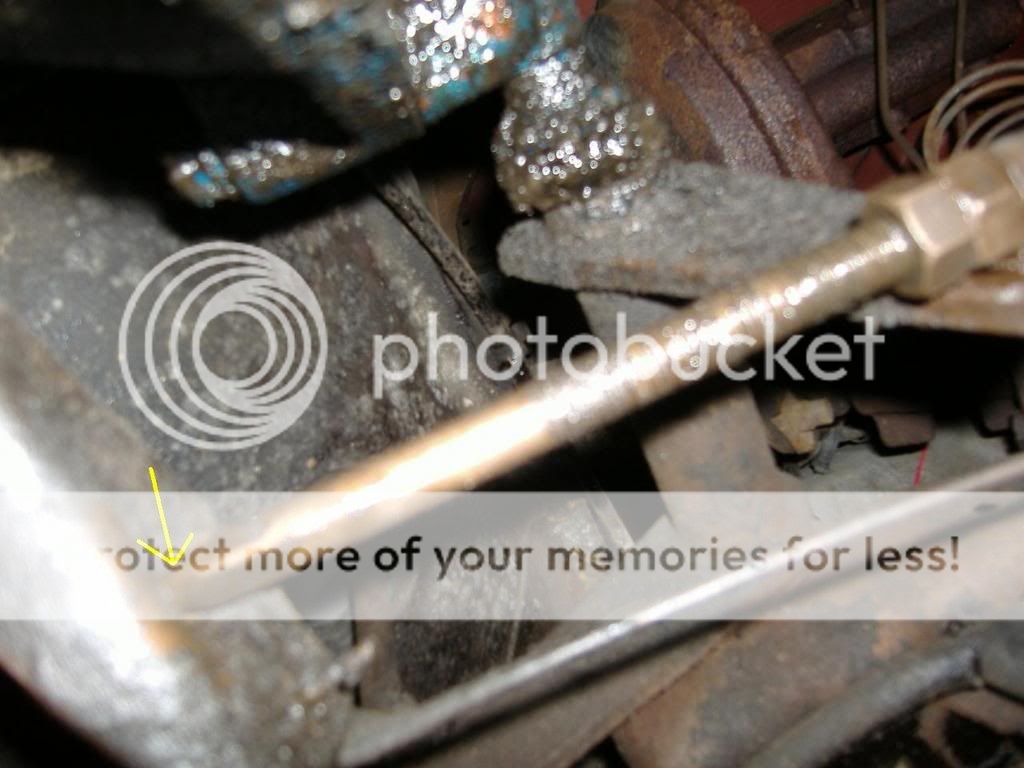

hey guys, my 79 f150 with the 300 needs its clutch adjusted again. but before i go ahed and make another adjustment, i have a question from last time i did this. the push rod that you see in the pic, the end where the arrow is, how is that suposed to be? last time i adjusted the cluth, this rod poped off with the slightest of ease, it didnt appear that it snaped off because the end was smooth. is it supposed to be just resting on that plate? it seems really weak to me for it to be like that, although it has never poped out while driving. or is that rod supposed to be cast or welded to that plate as part of a whole piece?

That's how it is suppose to be. I haven't seen that in along time. How is the spring? Did you replace it lately? I think the spring keeps tension on the rod and plate/fork.

Yeah that's definitely normal. It sits in there and needs to be able to pivot at that point. It's under constant pressure so it won't come out unless you pull it out.
