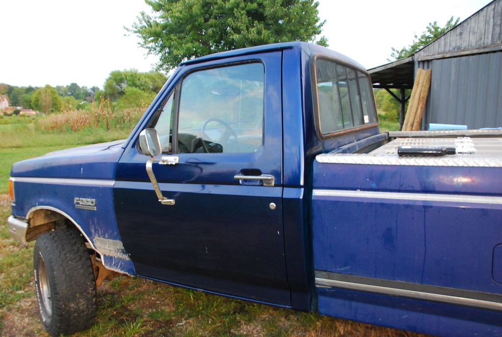

So, I went with the WD-40 (because that is what i had on hand) and it worked REALLY good. I let it soak for about 10 minutes then i used the razorblade to scrape it off and it came off super easy. I also picked up a can of the Goof-Off Extreme to use on the left over sticky glue. Thanks for all the good tips guys i really appreciate all the help!

Goof of was not strong enough to remove the left over adhesive. So i took my electric sander to it (and some other rust spots) and then primed over it, so i know i have a gray stripe down each side of my truck until i get time to prime the whole thing.
