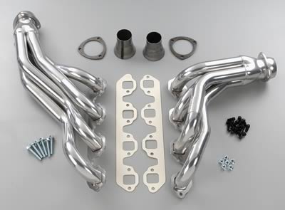

Those are the painted version of the headers I want, some $600 differnce. Anyway, a buddy of mine once told me that he had his painted headers sent out to have them ceramic coated. Is that a falacy? Will that actually be the same thing as getting the ceramic coated ones off the shelf for a little bit cheaper?

What kind are these, there nice and cheap, but are these shorties?
http://store.summitracing.com/partdetail.asp?autofilter=1&part=HED%2D89466&N=700 +4294908331+4294924755+4294908308+4294923429+42948 40123+4294918680+4294799365+115&autoview=sku
But these were the ones i have been thinking about, unless the tri-y header is better, where do these hookers match up with the doug thorleys and banks?>
http://store.summitracing.com/partdetail.asp?autofilter=1&part=HOK%2D6842%2D1HKR &N=700+4294908331+4294924755+4294908308+4294923429 +4294840123+4294918680+4294799365+115&autoview=sku

Those look like mid length headers. (If there is such a Thing) But I guess there actually considered shorties.
The Tri-Ys should give more torque at lower rpms than staindard 4into1 style headers.
You can buy Banks headers separtly. You can get them directly from Banks, however I don't know the names of sites offhand that sell them. Do a search for them. There are several places on the net that sell them separtly.
Those Hookers are definatly long tubes however the flanges are only 5/16" and the tubing is only 18Ga. For that price they should be built better IMO.
The Doug Thorley Tri-Ys have 14Ga. tubing and 3/8" flanges which are much thinker than the Hookers. You will not get as much interior moise from the headers due to the extra thickness of the tubes that the Thorley's have. Notice the Thorley's have a 2.5" collector diameter and most of the others have a 3" collector diameter. The smaller collector should provide more torque compare to the others. The Thorley headers are designed for trucks (Banks too) which require low end torque and not just top end hp like other header manuf. You can get the Doug Thorley headers directly from Doug Thorley and maybe you could get a better price by telling them you do not need the Y-pipe that comes with because your running duals.

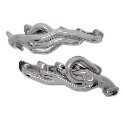

These are what I consider Shorties. (These fit my 6.8l V10)
