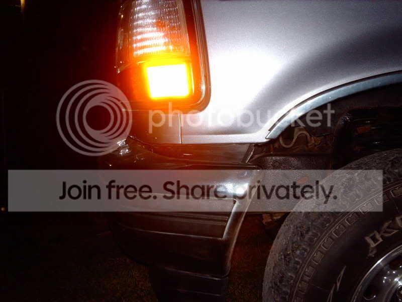

It happens when you run into something at low speed. The stock bumper mounting brackets are super weak and bend in a BACKWARDS direction when you hit something. It happened to my truck when I rear ended a guy several months ago:
Before, you can see my bumper was straight as an arrow:
After, you can see how rolled back it is, with no damage to the actual bumper:
I'm replacing mine with a heavy duty winch bumper soon Easy solution.
