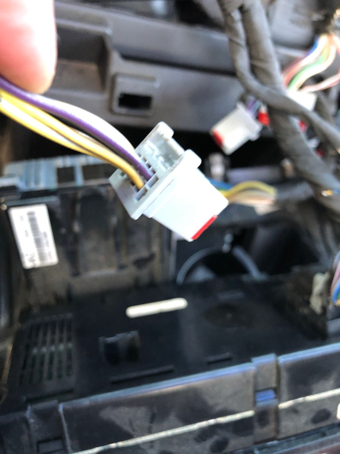

2010 F-250 Superduty - I followed the wires from the switches. They are blunt ends above the park brake. There is another set of blut wires just before the firewall on the inside (two blunt sets above the park brake). There is another set of blut wires, same colors, by the Brake MC under the hood. All are dead in any configuration of ignition/Switch placement. I have NO power to any upfitter switches. I have pulled the upfitter switch console and there is only one wire going into the switch. The single wire going to the switches does not have power in any configuration.
Any accurate information will be extremely helpful.
Best regards,
-Jay
This is the connector to the upfitter switches. I would expect to see 2 wires for each switch. Thank you again for any help. PS seat warmers work, fuse is good. -Jay

This is another connector that will fit but it only has 6 wires. Build book shows and 8 pin connector. No luck so far. Jay
