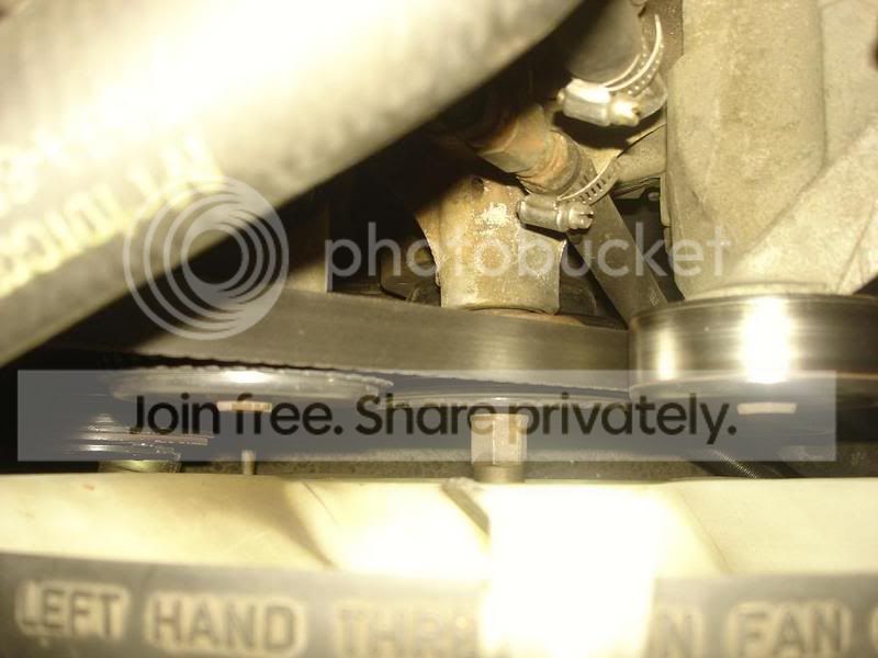

Can you remove the fan without removing the clutch on my 3.0 it looks possible remove the shroud and with a small socket or box end wrench loosen the bolts push the shroud back and maybe there may be enough clearance to remove the fan. If that won't work the radiator would need to be removed to get a bit more clearance.
If it does work the labor would be overkill for just the fan blades.
Its alot easier to remove the fan clutch. I used a chain wrench to hold the pulley and a large adjustable wrench on the bolt. There are also special fan clutch wrenches that hold onto the pulley bolts.
My 3.0 engine rotates counterclockwise so its a left handed thread. It was clearly printed on the fan shroud in raised letters. Left Hand Thread On Fan Clutch
I've heard that other Aeros possibly 4.0s make access for the adjustable wrench and chain wrench difficult. Here is a picture straight down from the top as you can see I have a clear shot down for a chain wrench and an adjustable wrench.
