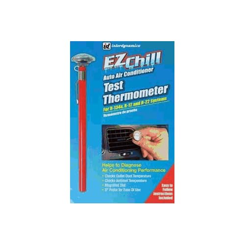

You should be able to pick up a thermometer at a good auto parts house.
Something like this. They have a range marked on them to tell you it's in speck. I use to keep one in my A/C register in my truck all the time. I've lost it somewhere now.
