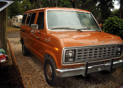

Well I got it home yesterday, spent most of today tearing out the carpet out of the cargo area.
Overall the van is pretty decent and very usable as is. The main problem is the drivers door which has dropped on its hinge. Is there a fix for this?, you have to lift the door as you close it.

Old Jun 3, 2007 | 11:15 PM
onereelbigfishy's Avatar
onereelbigfishy
Joined: Apr 2007
Posts: 43
Looks like a bargain for 370 bucks. I paid 5k for mine. But its a diesel quadravan. There are door pin bushings that you can replace to make your doors latch right again. I havn't done it on mine yet but I bet you can do a search and some info will come up. Or someone else will chime in here about it.

Old Jun 3, 2007 | 11:33 PM
pfogle's Avatar
pfogle
Joined: Feb 2003
Posts: 8,140
From: Oak Harbor, OH
Ok, the doors from 1975 to 1991 are the same from the E100 to the E450. 1992 E250 on up doors will fit. NO F-series door will fit. Front seats same thing. They didn't change at all from '75 to '91 cosmetically. You might even be able to use the newer model seats I don't know I never tried.
Old Jun 4, 2007 | 12:06 AM
NumberDummy's Avatar
NumberDummy
Ford Parts Specialist
Posts: 88,826
Likes: 785
From: Simi Valley, CA
Ford no longer supplies the hinge pins, and they are a real pain to change. The hinges are the same 1975/91, and are the same right/left upper.
Old used car dealers trick to fix sagging doors: Get a 5' 2X4, put one end on the ground, the other end on the door sill about midway. Move the door till it touches the board, then push the door up the board a couple of inches, then tighten the hinge. Do not loosen the hinge beforehand.
Old Jun 4, 2007 | 06:54 PM
Zralou's Avatar
Zralou
Joined: Nov 2004
Posts: 25
Thanks for all the input guys.
I'll try that hinge fix trick tomorrow, i'm all for free fixes!!.

Old Jun 6, 2007 | 07:08 PM
Zralou's Avatar
Zralou
Joined: Nov 2004
Posts: 25
Well I didn't have any wood long enough to allow space to get to the hinges. But I did manage to get the door lined up using a diferent method (B F H ), so for now it's lined up with the striker and closes if you slam it, but at least now I don't have to lift it to close it (which was a pain from the inside).
