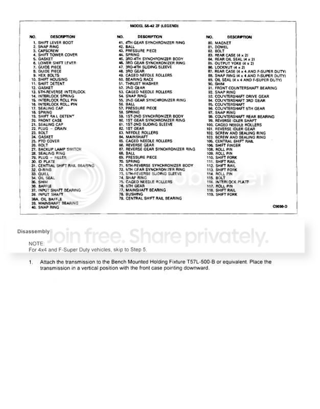

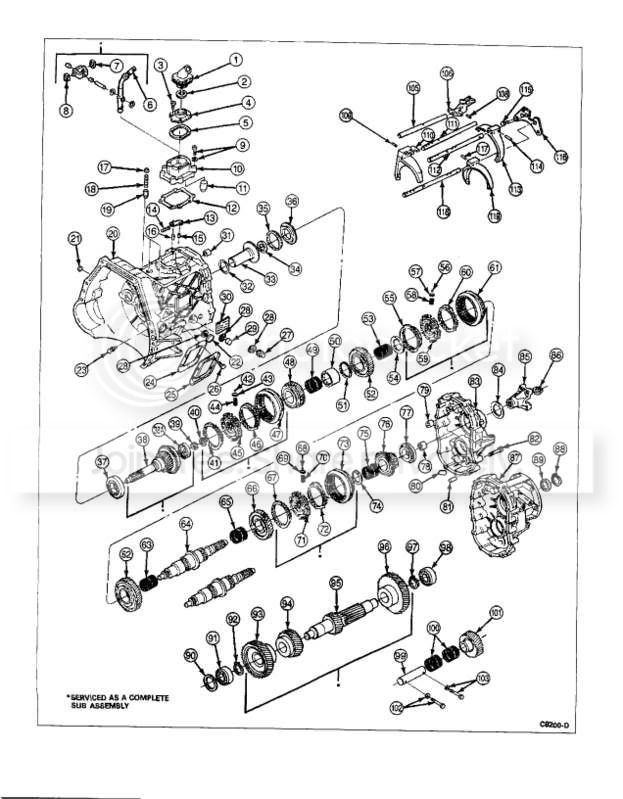

There are sliders on the mainshaft that are composed of a sliding sleeve, synchro body and synchro. When the slider moves toward the gear when you shift, the synchro, through friction, equalizes the speed of the gear and the mainshaft so the gears don't grind. The synchro you're looking for should be on the back side of 2nd gear on the mainshaft and you may be able to see it from the PTO port. Look at #s 52-61 in the diagram:

how hard would that be to change out a synchro? would that be something that someone with average to good mechanical knowledge be able to tackle? or are we talking transmission shop?

You know what you are doing and I'm sure you could replace a synchro. I don't necessarily think this is something that has to be done by a shop. You just had the trans rebuilt so the bearings seals, etc. should be in good shape. Years ago I put new synchros in a 4 speed Muncie M-21 and it was a 2 hour job. In the Ford shop manual the ZF looks a little different and more involved. You remove the bolts holding the rear case on the transmission and lift the front case straight up. You then have the "gear pack" -mainshaft, countershaft, and shift rails sitting in the rear case. Ford has a special tool called "gear pack holding fixture" and nylon sling that are placed around the gear pack and the assembly is then removed from the rear case. Once it is removed, you could take the mainshaft out and replace the synchros. I could scan the ZF transmission disassembly/assembly instructions and email them to you if you decide that's what you want to do. Send me a pm or email with your address. I've learned if it's got t!ts or tires it will give you trouble.

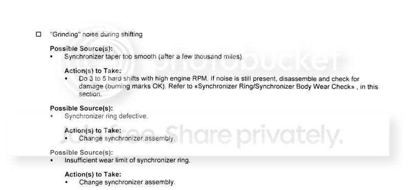

Did you get that image out of the shop manual?? As I was looking at it, there at the bottom, it said that the taper was too smooth after a few thousand miles, and to try some hard shifts at high RPMs and see if that fixes it... I tried it, went up to 4200RPM (cringe) in first, shifted to second, went to 4200 again (cringe more), and then up to third. Did that a few times, and for now, I can downshift again normally, so it might be fixed for now, but that's probably an indication of them being going and it'll need to be done soon.

I don't think it's possible to replace the synchros without removing the trans. I can get you a copy of the instructions in PDF format. It will take a while to scan so I won't have it together tonight or maybe even this weekend. Let me know where you want me to send it. Yes, that info came out of the shop manual and that corrective action looked like the most fun way to try to fix a problem that I ever saw in a shop manual.
