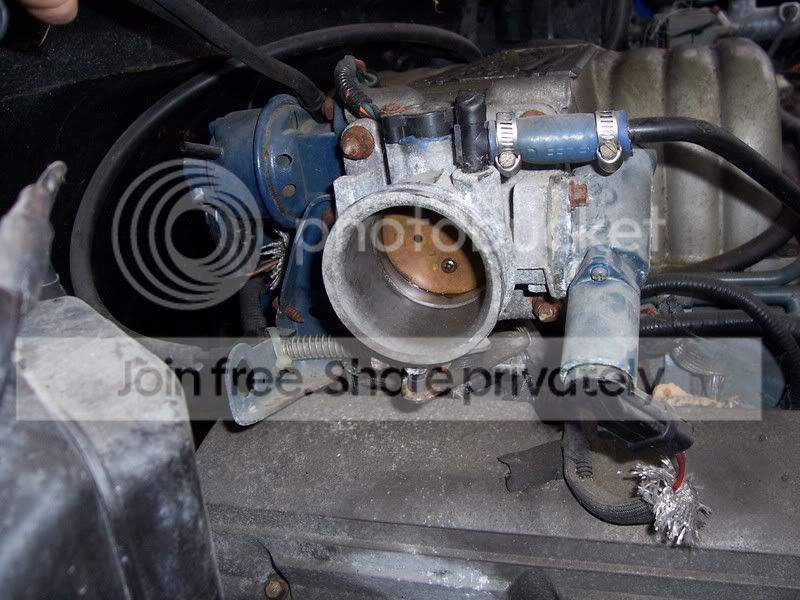

hey guys, newbie to THIS forum and F250's but not cars in general. so here's the deal. my bro-in-law has an 89 F250 with a 5.0HO motor insinde. the previous owner did a hack job of an install. we just got it running recently but its running really rich and eating gas (6mpg). i'm just wondering if you guys might know about these particular parts of the TB and if this is whats causing it. the blue dashpot is not hooked up to anything and the jimmy rigged vent doesnt seem to be airtight. also wondering if its computer controlled (is it under the dash?) any help would be appreciated. thanks guys.

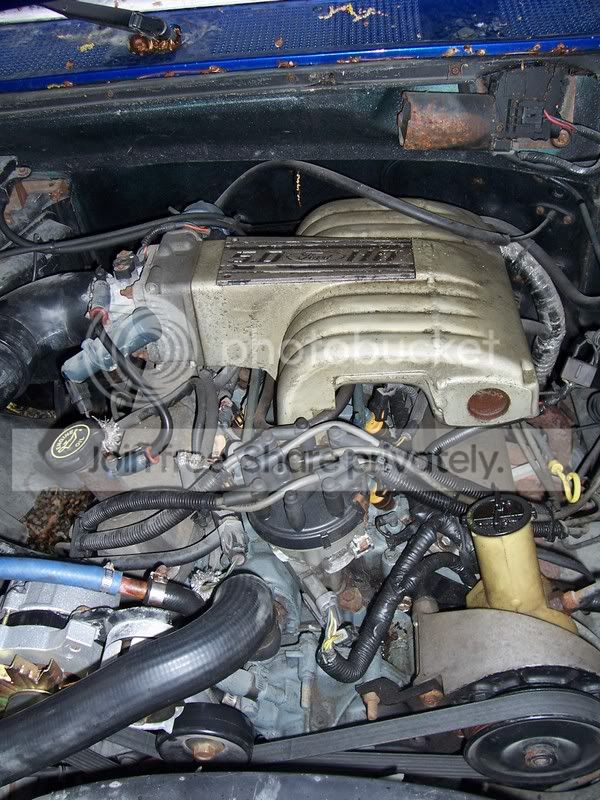

here's a pic of the motor. just want to make sure that it's not a 5.0 intake manifold bolted to the block. it's not misfiring, but i will check the timing to make sure it's within spec.

Sure looks like an 86-88 Mustang SEFI engine. Check my gallary for pics of my conversion from years ago.
As for the blue dashpot as you call it...that is the Idle Speed Control motor. It adjusts idle for cold/ac/in gear situations. I am amazed it isn't hooked up!
Poor mileage, is there a thermostat in it? These engine need to run 190 degrees so the computer doesn't keep it on "cold run" condition (extra rich mixture). Does it surge at idle? Looks like a speed density engine and they do like to surge if not set up correctly. The pcv vent is correct though you are missing the TB warming hoses (not required). The EGR system if not set up correctly can cause poor running, major fuel consumption. Purchase the Probst book on Ford Fuel Injection and start reading.

we hooked up the dashpot to the intake maniford vacumm and that solved the rich idle. Now we are having problem w/ slight serging and motor flooding it self out. Sometimes we have to disconnect the fuel relay to start the truck.

Is the dashpot you're referring to the blue thing to the left of the throttle opening in your first picture? If so, that's the EGR valve and should connect to the EGR valve regulator (EVR) so the computer can control it.
