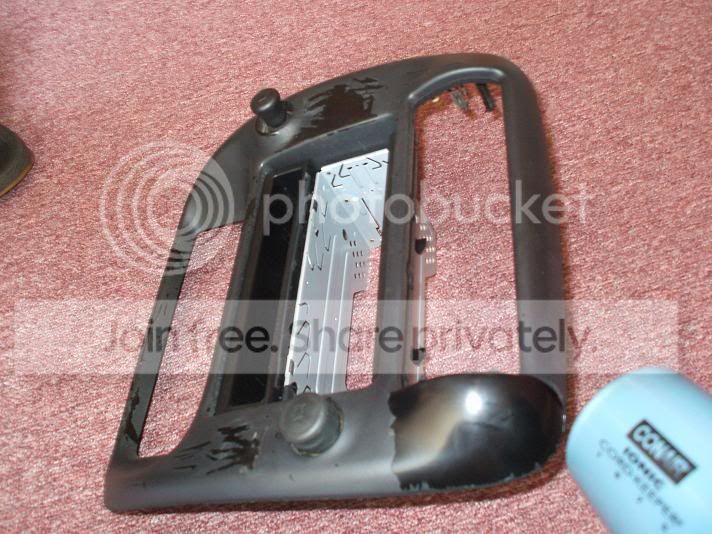

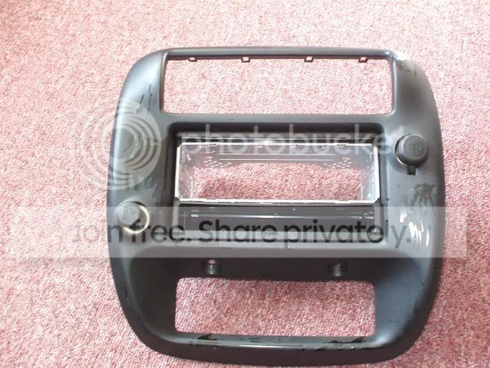

Its finished! Its amazing what a cheap hair dryer and some elbow grease can do!
Heres what it looked like before I started
Heres what It looked like after about 5 mins
It took me about 45 mins to clean everything off and clean up the mess on the floor haha. Heres what it looks like installed

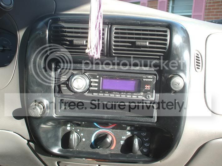

Here it is!I think it looks alot better now than it did before. I still have to wipe it down because of all the fingerprints on it. Im still debating if I should leave it the black, or paint it flat black or paint it the same color as the exterior: candy apple red.Any suggests or comments?

I'd say go flat black. I've done the whole painting of the interior in the exterior color. It can look good, but looks out of place with just a few things done. Flat black is universal and looks good.
Here's what some well-spaced black will do on a grey-interior truck (with blue exterior). After doing black seat covers to match, plus the console and shift boot being black, I've gotten several compliments.

reminds me of my 94. I miss that tough truck. I put it through hell and back and kept on running. Is that a tach in ur air vent? I was thinking about doing that, how hard was it to mount and run the wires?

4 ways! lol. They're in the back now, I got Polk components up front (wonderful difference!).
It's a vacuum gauge in the "air vent" actually. It was pretty easy, I removed the vent panel (hardest part), popped out that filler where the 4x4 switch would go, and drilled a 2" hole from the front (very very carefully as to not crack the plastic vanes). Trim it up nice with a Dremel tool.
I ran the vacuum line up through the dash to the location where the gauge would go, then ran three wires back down the line (power, ground, and lighting). I taped the wires to the line to keep it all together, hooked up the wires, installed the line to the gauge, and pressed the gauge into place. Reinstalled the panel, hooked up the wires (now to my other aftermarket gauges...the best place, IMHO, is the ashtray light for lighting), and tested it out. Works great.
Little bit better picture, not too great, sorry.
