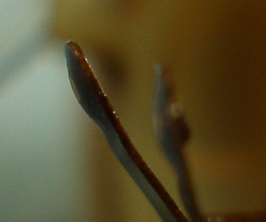

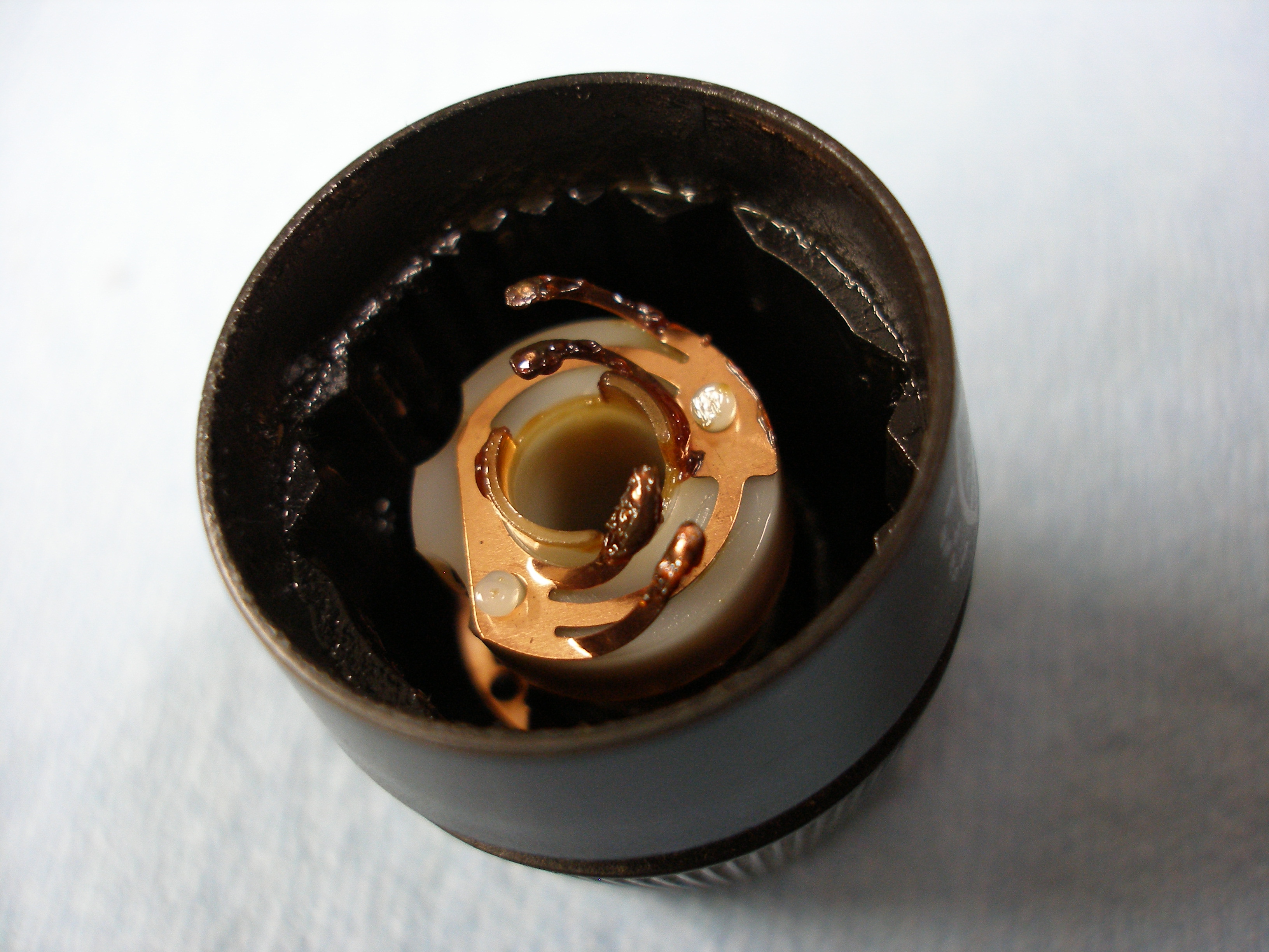

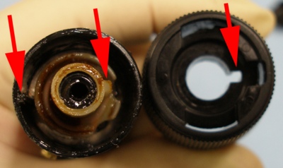

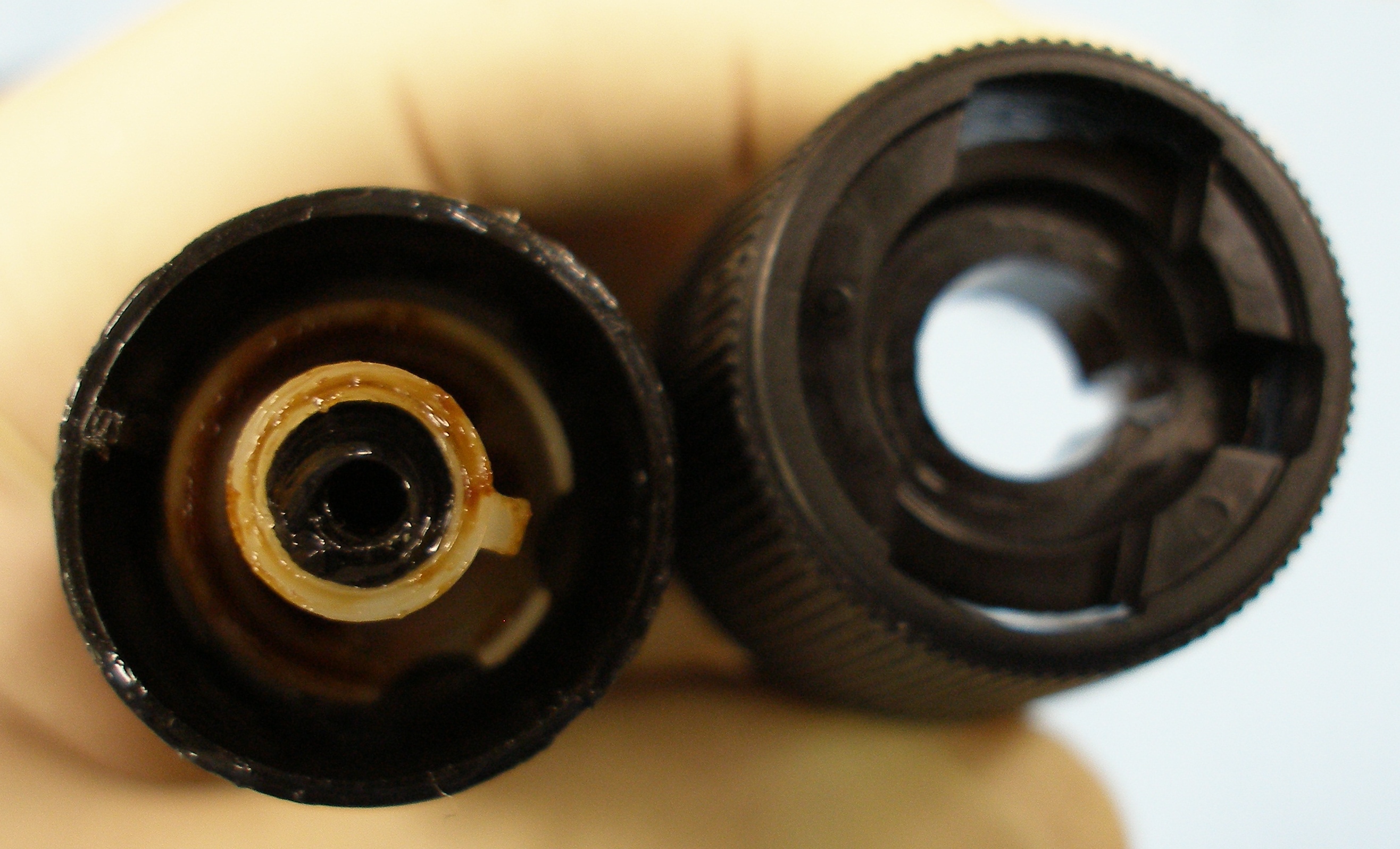

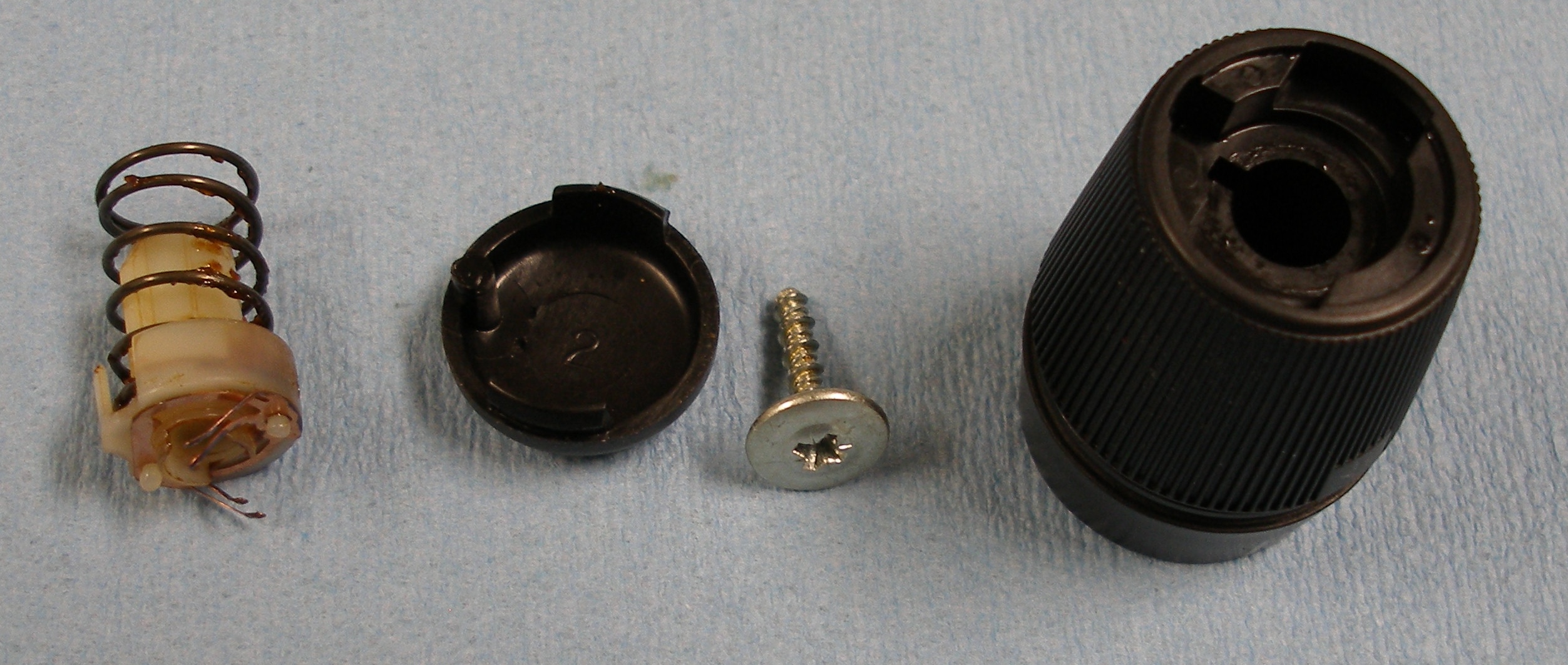

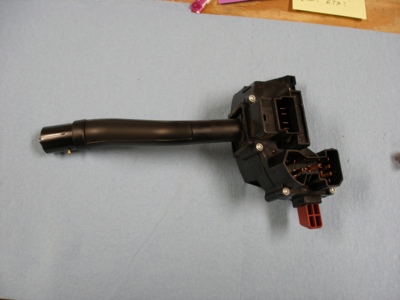

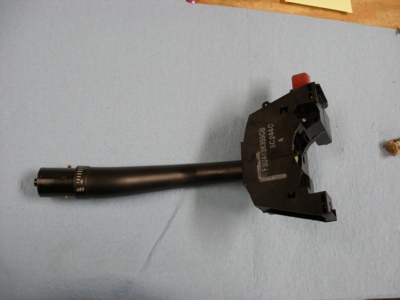

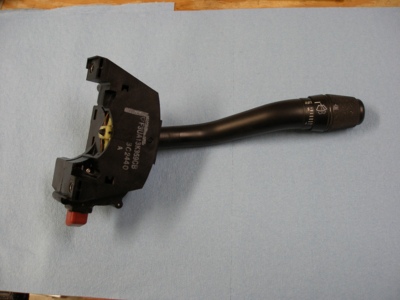

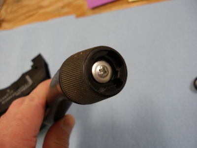

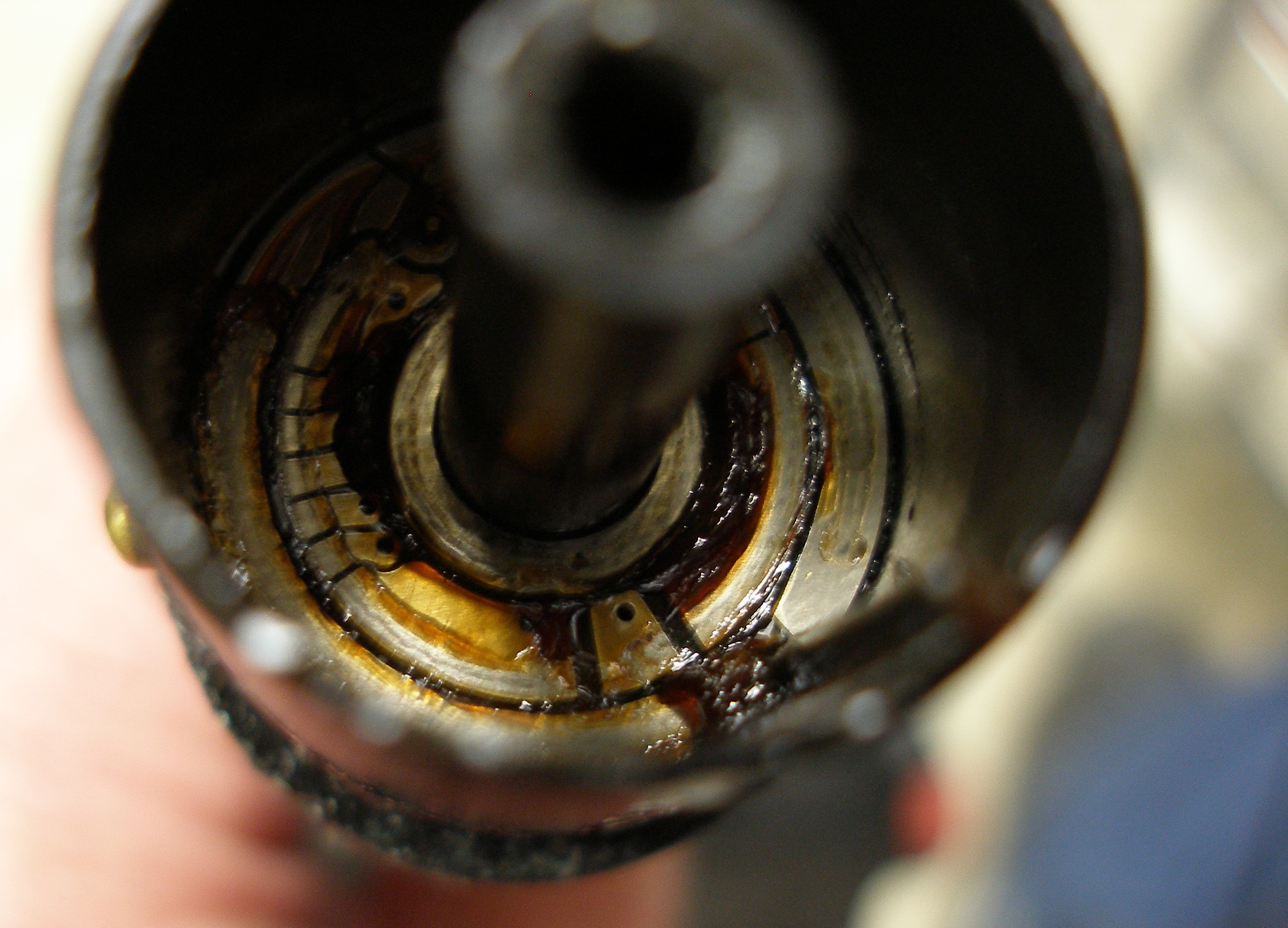

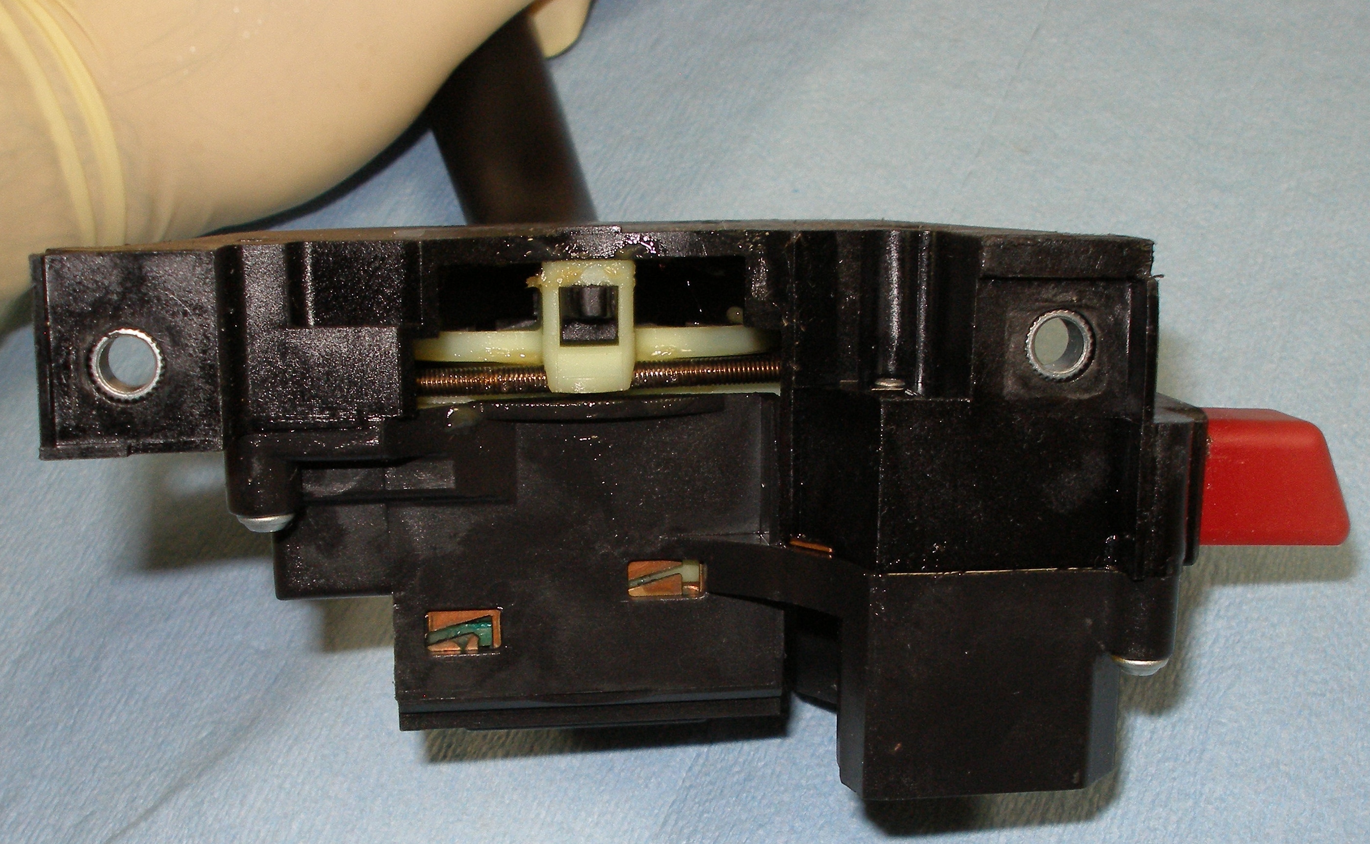

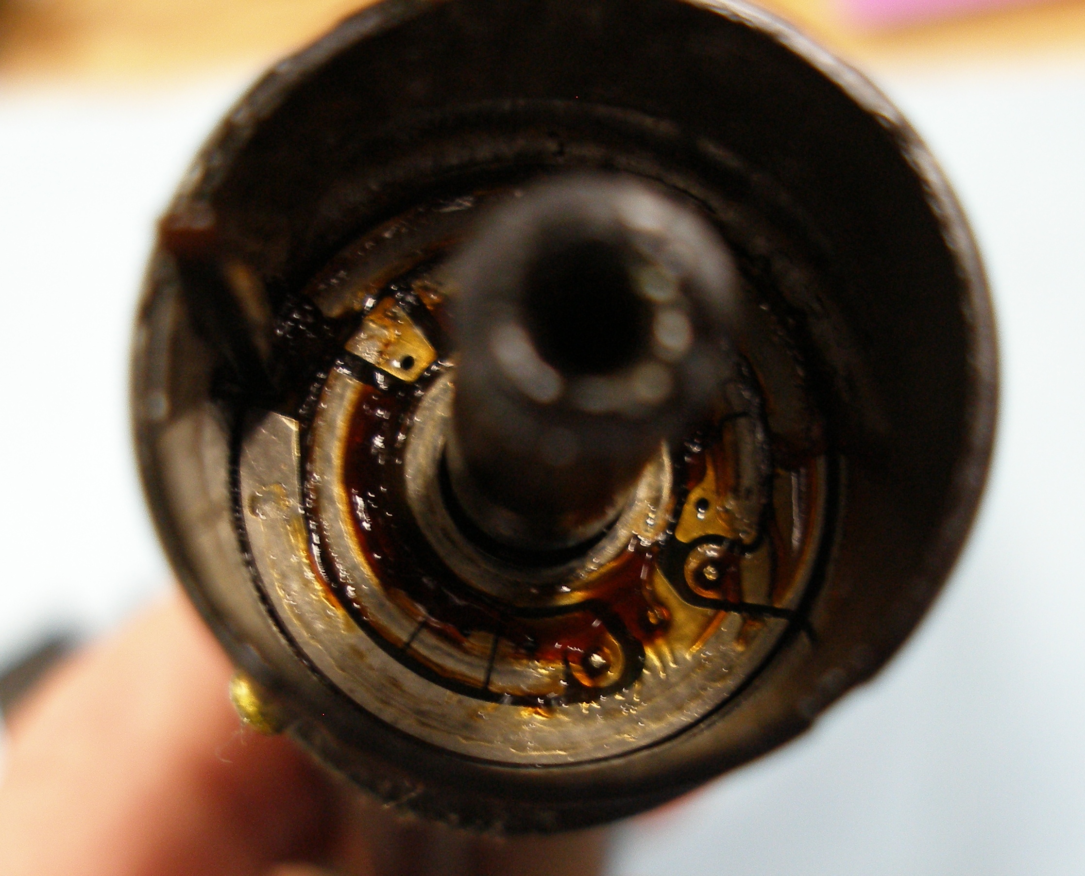

I had a chance to take apart one of the MF Switches I bought at the JY last week. The Delay Switch is very easy to disassemble, and almost as easy to reassemble. I was somewhat surprised to find that it's not a pot, but a set of discrete contacts. Some pics here (click on any image for larger) (arrrgh, too many pictures per post, blech):
(con't. in next post)

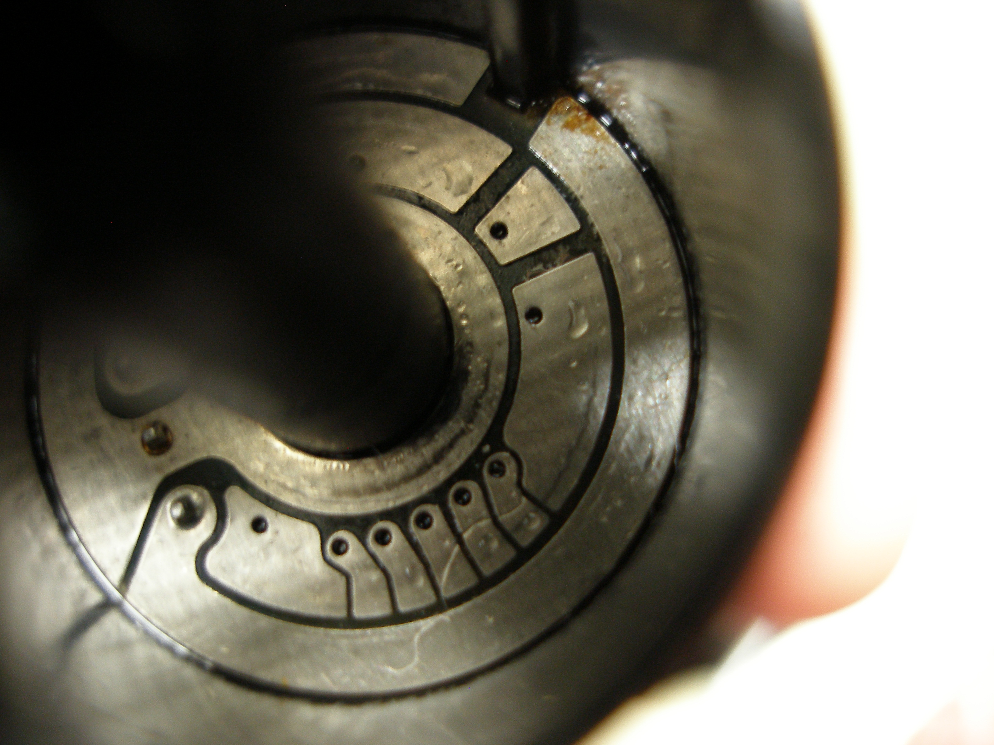

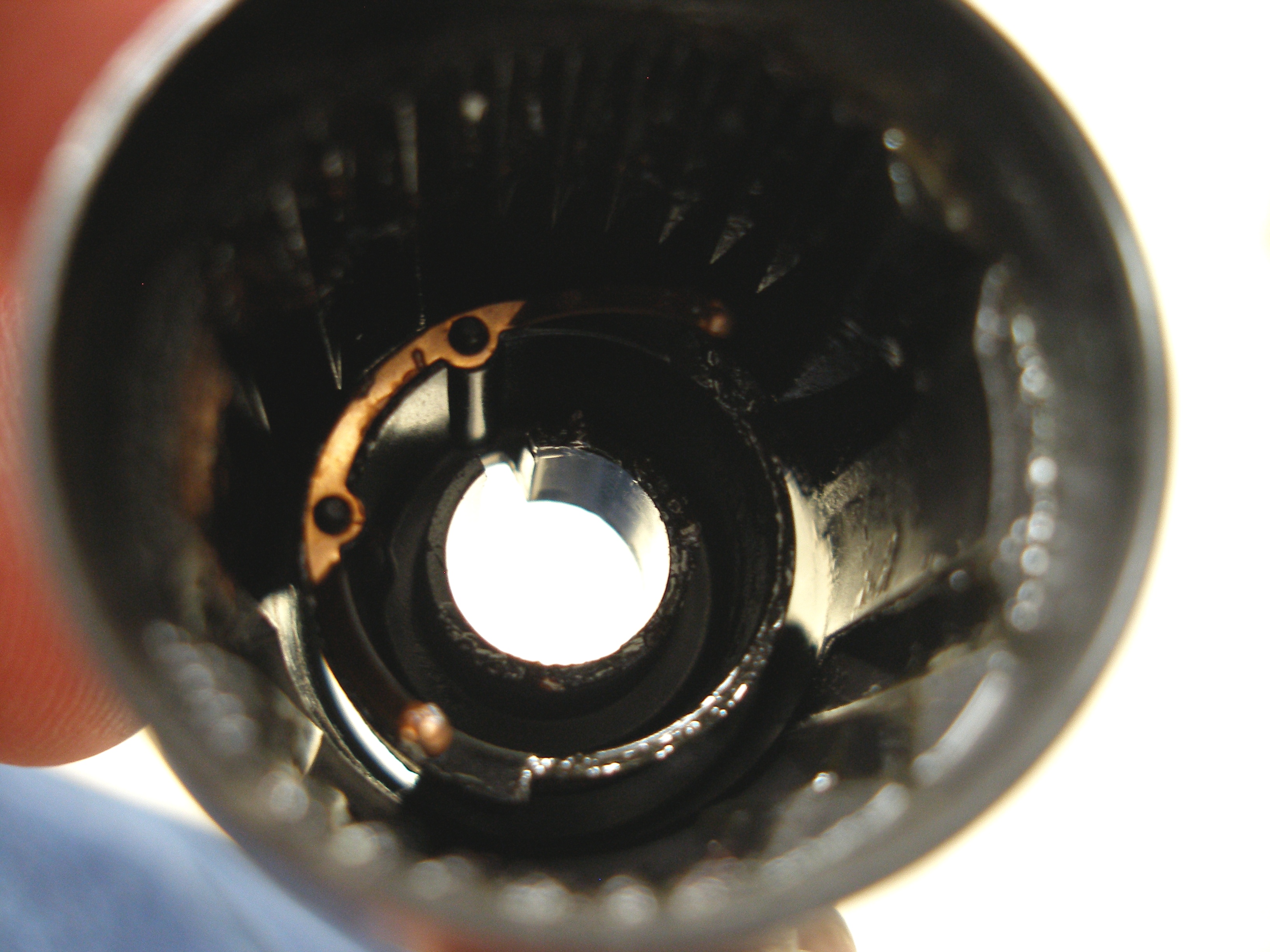

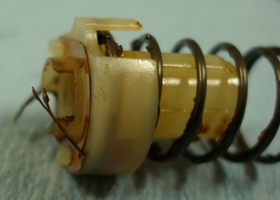

In this first pic, it's not my best work, but there is a 'U'-shaped contact that is barely visible in its entirely. Sorry, I wasn't using proper lighting for that shot (click on any image for larger):

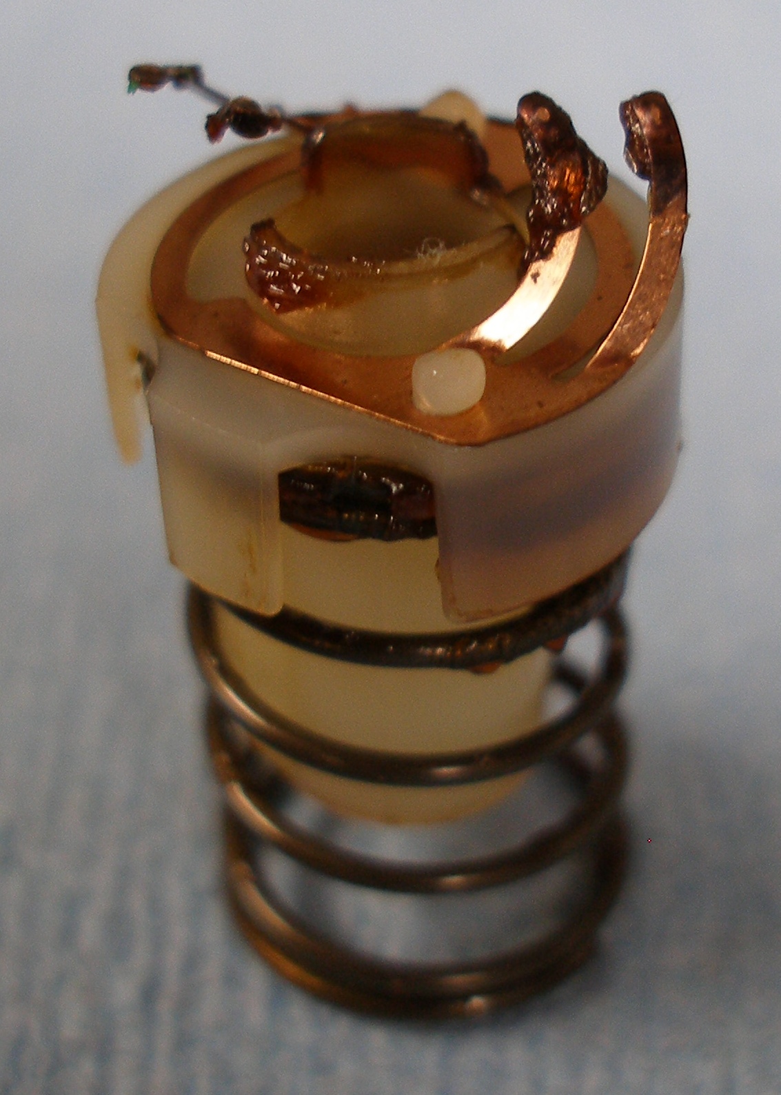

I cleaned/removed almost all the original grease and re-lubed it with Tri-Flow silicone/teflon grease instead.
The only modestly-tricky part is reassembly at this point. If you drop the spool in and orient its drive tab 180° away from the arm's inner tab, then the **** will drop right on. There's some leeway, but 180° works well and is easy to remember.

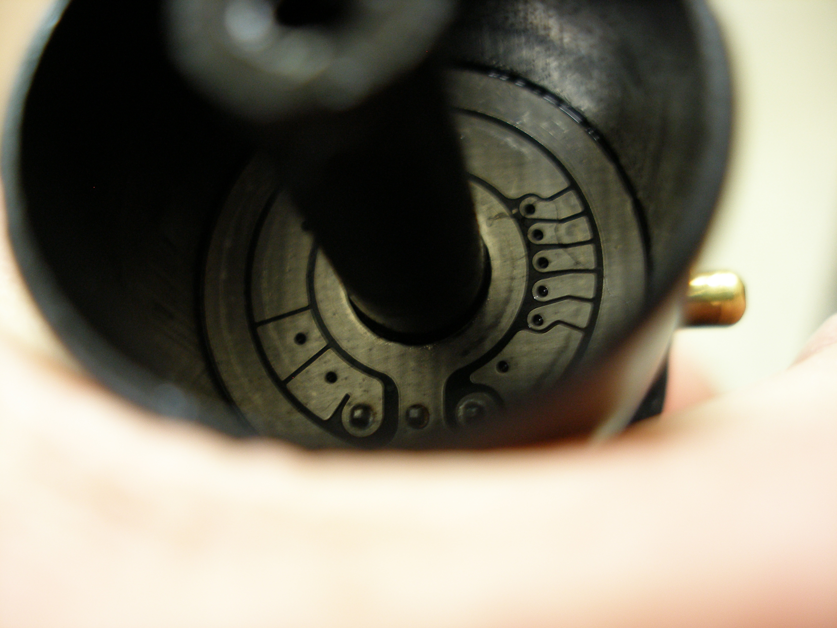

When I get more tech info on the '93, I'll see if I can suss out which contacts do what. I suspect the larger, outer ones are the WW squirter, but that's just a guess.
Nobody should be afraid to take theirs apart, but I bet that if there's a problem with it that you can't do much about it, other than clean and lube it. If that PCB gets worn or etched, that's very difficult to repair. I wonder if it can be fished out and swapped with a used one . . . but if you do that, you might as well change out the assy, as you'd have bought the whole used one anyway.
