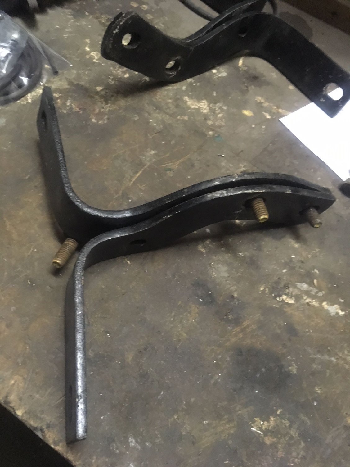

I have a 66 flareside. I have the rolled channel bumper. painted. I have a set of brackets for this bumper but they do not sit right on the truck. I know Number Dummy has posted this many times and i believe mine are correct. I have also read that these were dealer installed and maybe my holes were drilled incorrectly. I am attaching a copy below of my brackets.
I see that MACS sells this one, but it looks much different than the one Number Dummy says is correct.
Part #: 48-27652-1
Alt Part #: B5C-17787-UST
Anyone have any thoughts on if mine is correct? Maybe i need to weld in the holes and redrill?
Thanks

This is Mac's "made up" Ford part number for these:
2) B5C-17787-A (replaced BBAA-17787-A) .. Bumper Bracket - Right Outer & Left Inner.
2) B5C-17788-A (replaced BBAA-17788-A) .. Bumper Bracket - Right Inner & Left Outer.
1948/52 F1 & 1953/56 F100 (all except Panel) / 1948/52 F2/F3 & 1953/56 F250/350. Plus: 1932/47 misc trucks, ditto the bumper.
The painted channel bumper (BBAA-17906-A) is the same, but 1948/56 brackets will not fit properly on 1957/72's.

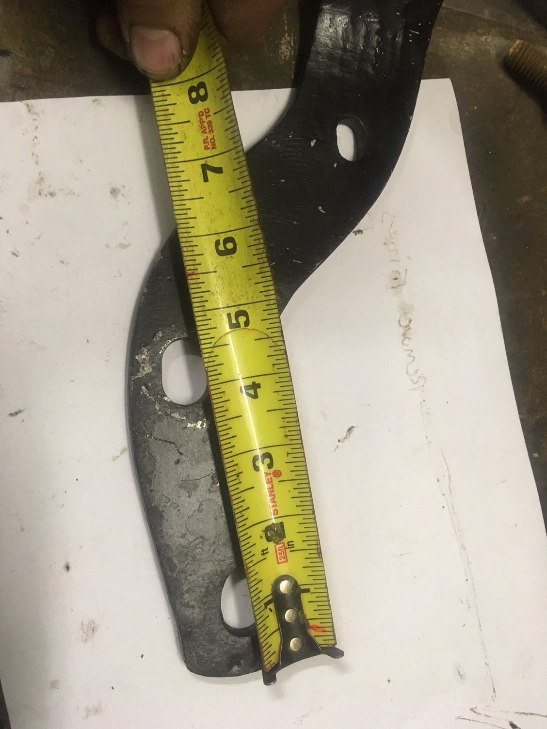

Thanks for the information.
I cannot seem to find any numbers on my brackets. I do have a measurement on the part that bolts to the frame. I have about 4 1/4" from the back of the bracket to the center of the second hole. If that helps any?
Is there any way of knowing if mine are for 1948/56 or 1957/72?
