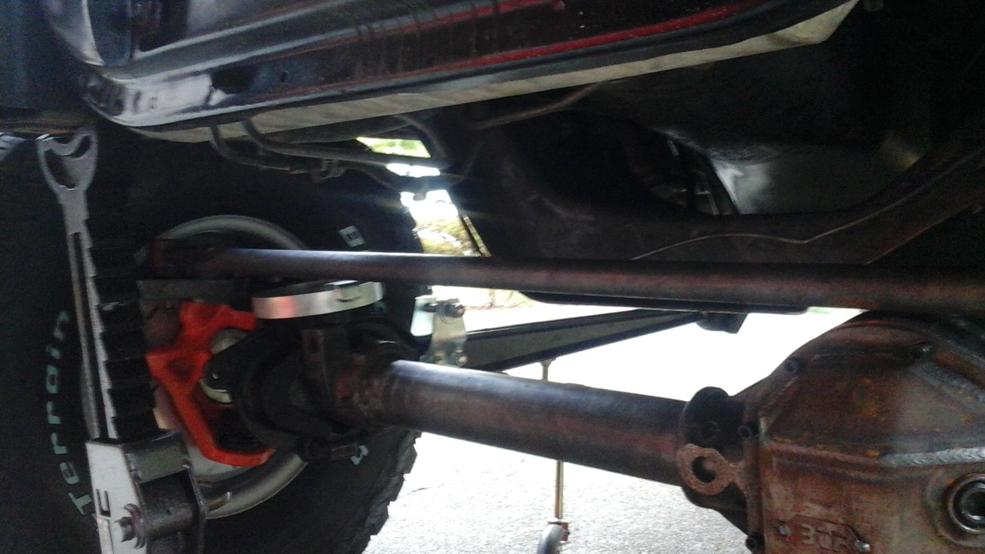

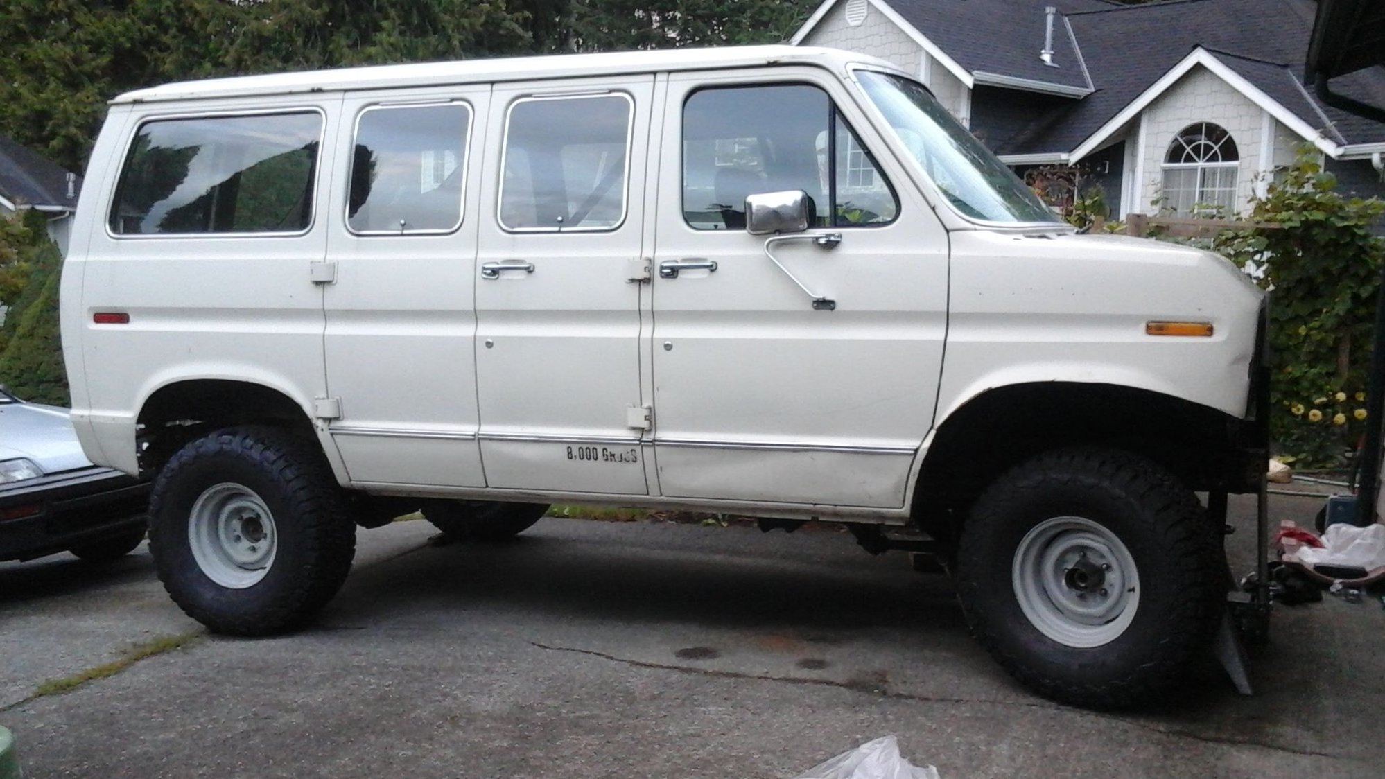

Here are some from the current progress:

Some pics from the end of the trans rebuild and conversion:

Cool! I've wanted a 4WD van since reading magazine articles about the Pathfinder conversions back in the 70s. Of course they're in a long line of vehicles that I want, and I won't get many of them. But it's still fun to live vicariously.

same here Bob. my goal is a 4X4 1 ton diesel van i can keep all my tools in like a rolling shop for doing repairs on site when plowing instead of having to haul the broken plow rig back to the shop, or loading up the needed tools and hauling them out to the site.
