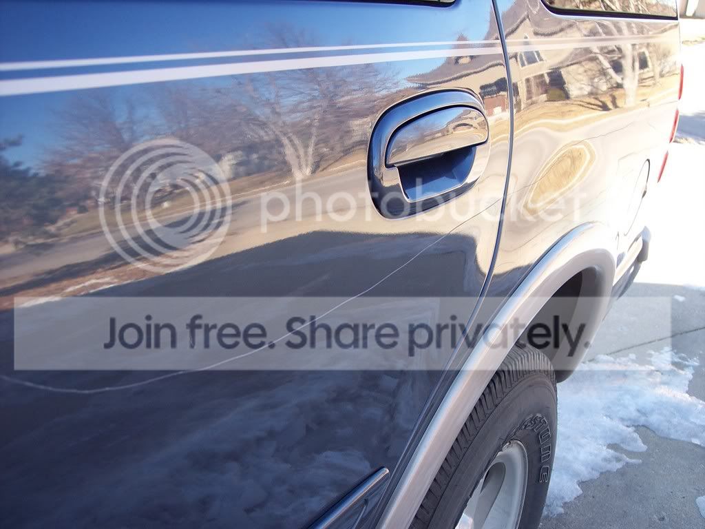

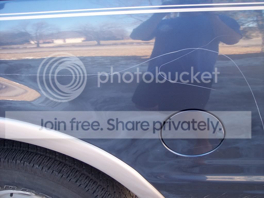

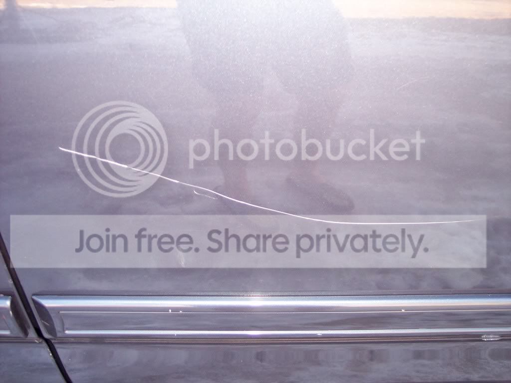

Well guys, I got some pics taken. Here they are:
It's a deepin' ...

That is horrible. I feel bad for you. Where I live(N.Y.C) you could get you car keyed up like that any day of the week, for the stupidest reasons. I hope you find the sob that did it and take him to the proper authorities.
The best advice i can give you is to try and have the car compunded and then waxed and glazed to see if that can help eliminate or hide your scratch. Ive had a similar scratch on my rear quarter panel(although it was done accidentally). It is amazing how much better a scartch will look if you take very good care in applying touch up paint. Although repainting the affected panels would be the best way to repair the damage done, you should definitely look into either trying to "buff" the scratches out, or carefully touch them up and them color sand them in with a very fine sandpaper and lots and lots of water. Followed up by an extensive polish. Good luck brother! I feel your pain.

Thanks for the ideas, Greenscobie. I talked to a local paint shop, "Best technitions in the US," and he said $1500 to get it fixed would be top of the line. Repainting the door, the back quarter panel (all metal pertaining to the quarter panel), as well as blending the driver's door. The other option from this joint would be for about $150 and they'd just "touch it up." I'm calling back here in a few to find out exactly what touching up would entail but I'm definately going to mention all the good advice you guys have given me and find out more information.
I guess I could always go with MAACO. I called them and they wouldn't give me any quotes over the phone but I finagled the guy to give me some numbers. My guess to have it done "top of the line" would be somewhere in the $200-300 range.
What do you guys think I should do? I don't want to spend $1500 but I don't want to go MAACO if they won't do as good of a job as the $150 from the "best technitions."

I would start with the least expensive way first. Wet sand the scratch with 2000 grit or med to fine grit rubbing compound (3M compounds work best), your goal is to remove as much of the scratch without going through the entire clear. Then go with a polishing compound, and last a wax. This will minimize the amount of touch-up needed.

Yeah, I think this job will require a pro. Get an estimate, maybe your Comprehensive coverage will pay some of it minus the deductible. It's vandalism. Good luck.

Thanks guys for all your replies. If wetsanding involves any sort of tool then that choice would instantly be out of my price range haha. Hopefully that package for 150 frosties won't be too bad and will take care of my needs of not wanting it to stand out as bad but still not be able to see a line of touch up paint where the scratch was.
