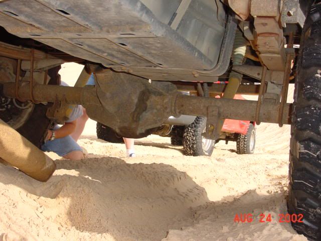

courtesy of firezapper
aftermarket blocks break. on my f150 i stacked up original factory blocks to get the lift and then got underneath and did a messy job of welding them together. factory ford blocks will never break.
