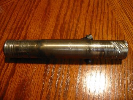

I stopped by the shop on the way home from work, I'm lucky things aren't a lot worse than they were.
Here's the pin and the broken bolt; I'm loving the bend in the middle of the pin. I'll get the carrier back too once the new parts come in.
Enjoy!

Wow... man you are lucky! $800 is not bad at ALL!
