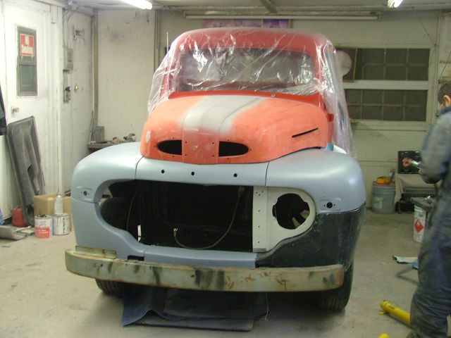

The front fenders are slightly different. I didn't know this until a couple of weeks ago with Don McKay posted pictures of his Merc. Theres' a stamped area in the front fenders for the parking likes:

Thanks for the info again. I found a local mercury truck and just wanted to know what I might be getting into should I decide to go that route.
BTW, that picture above is awesome. I love seeing works in progress.
