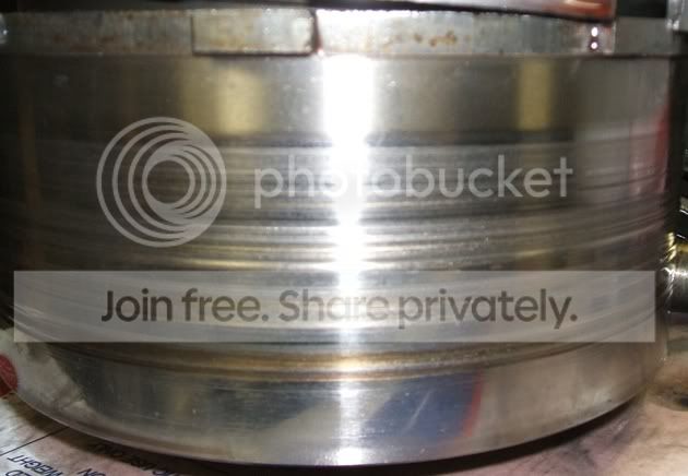

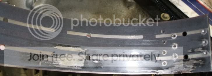

If the intermediate drum is scored the band is probably toast as well.
Repair it now while it's out and apart.

How bad is the scoring on the drum? how deep are the grooves because i would just go get a new drum itself.

Oh yeah the band is toast

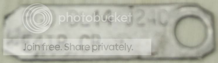

there is a tag that came off the servo cover what does it mean and how do I find out the ratio, because I've heard that R ratio is better
In case you cant read it, it is PGD DL14 J24C
E4TR CB

PGD-DL14 is the part number as for the J24C-E4TR-CB digits i dont know yet. And about the extra friction n steel plates, there might be some that are special heavy duty models built by performance transmission shops, but in order for that to work you generally have to machine the drum along witha few other things possily to accept more friction n steel plates.

What do you guys think about the drum, I think its toast

I agree, the drum is toast. You should be OK with the manual if you have done one before. One thing that I did on my last C6 rebuild was to increase the clutch count. I am running 6 frictions and steels in each clutch pack. If I remember correctly, I used the highest capacity stock drum, left out the wavey plate and machined the pressure plate. I am using mine in a heavy tow application and has so far been beat hard for about 3 years. When I do my regular fluid changes, the fluid coming out looks like new. Sure is nice when a plan comes together. One more suggestion, if you do get a video, put the remote in a ziplock bag, ha.
